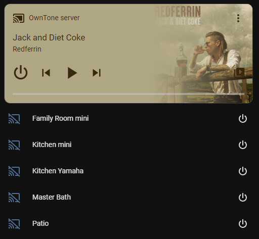

I want to be able to pick a playlist from the dashboard (e.g. Spotify Lovelace Card) and tell it to play on one or multiple specific homepods. Bonus points if I can see the album art etc. on the player card.
Yes I did. I folllowed the OwnTone instructions and can play Spotify content (playlists, artists, etc) to one or more Homepods. The only catch I found is that I have issues if I try to setup a 2nd instance with another Spotify user’s profile. It seems to work best with only one. In the screenshot, Kitchen Mini and Family Room Mini are Homepods.
Thanks, thats encouraging. But where do you select to which homepod you want to cast? I can create a media card with the OwnTone Server just fine, and pick my Spotify playlists from the integrated media browser, but I don’t see a way to tell it where to cast right from within my dashboard. I’d have to change it from the webserver frontend.
EDIT: Nevermind. Figured it out by looking at your screenshot some more.
You add one media player with the OwnTone Server entity to pick and control music. You add other media cards with each of your player entities (homepods etc.) and just use the on/off icon to activate/deactivate them.
Sorry it’s been a while so I don’t remember exactly, but I think you have it right. From what I recall, the OwnTone server handles the media, and each speaker is a separate media_player.xxx entity.
