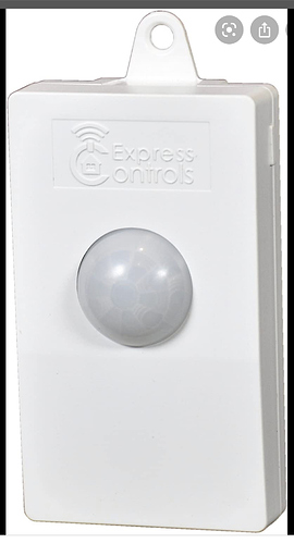

Doing a little digging myself. So it does look like there are two different versions of the hsm200. V1 looks very similar to v2… except version two has a screw tab on top like below. Which is exactly what I have.
V2 lastest firmware is 2.2
V1 latest firmware is 1.10
I noticed that your is 1.8 so you have v1 and can update to 1.10. That may or may not help. If it doesn’t help then looks like you’ll need a v2.
Here is a forum post talking about it. Luckily there is a link to firmware 1.10 for v1 in post #9 if you wanna try it out.
