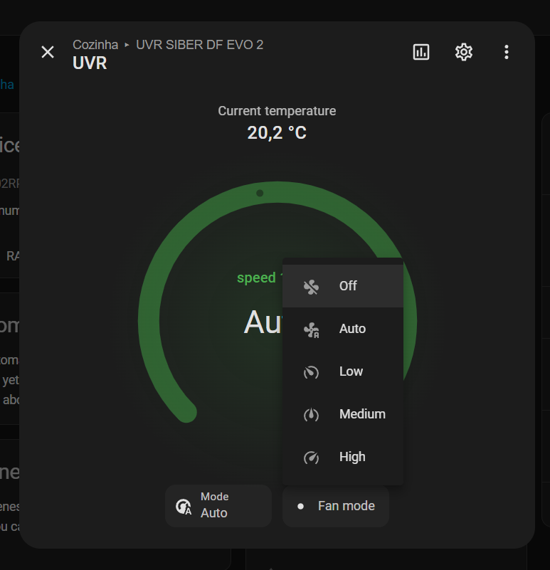

I don’t have a Nuaire, so can’t check, but I suggest setting the device class to FAN, not PIV.
What do you see in the system monitor/ramses log. Look for 31DA and 22F4 payloafs.

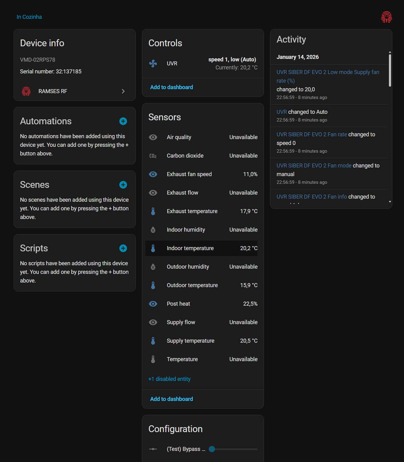

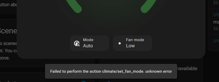

My unit behaves the same way, no updates on the entities. It has always been that way. Not sure whether the PIV is not sending the data or this integration is not coded to process it.
Sorry, I didn’t make it clear. I did set the device class to “FAN”. I’ll try capture some packet log entries and see if I can work out what’s is going on. It may well just never send any data out about it’s status.
Good to know it isn’t just me.

The latest ramses_cc Release 0.53.1 broke my Siber DF EVO 2 (a VMC unit) functionality.
Many sensors and entities are unavailable and the available actions are now only these:
The previous configuration was as follows:
"18:150316":
  class: HGI
"32:137185":
  _note: SIBER EVO2
  class: FAN
"37:145236":
  _note: SIBER EVO2 Multicontrol DFEVOCTRL08
  class: REM
  commands:
    away: " I --- 37:145236 32:137185 --:------ 22F1 003 000107"
    boost: " I --- 37:145236 32:137185 --:------ 22F1 003 000707"
    bypass_auto: " W --- 37:145236 32:137185 --:------ 22F7 003 00FFEF"
    bypass_off: " W --- 37:145236 32:137185 --:------ 22F7 003 00C8EF"
    bypass_on: " W --- 37:145236 32:137185 --:------ 22F7 003 0000EF"
    calendar_off: " W --- 37:145236 32:137185 --:------ 22B0 002 0006"
    calendar_on: " W --- 37:145236 32:137185 --:------ 22B0 002 0005"
    high: " I --- 37:145236 32:137185 --:------ 22F1 003 000407"
    low: " I --- 37:145236 32:137185 --:------ 22F1 003 000207"
    medium: " I --- 37:145236 32:137185 --:------ 22F1 003 000307"
  faked: true
and from what I can understand the VMC should be controlled via the fan entity, but the options available don’t match the commands and most importantly don’t work. Note that the screenshots below are from the previous version and sensors are working here stop working in the new version; however the fan device has mostly the same behavior though i think it shows speed 1, 2, etc and doesn’t work either.
Does anyone have any hints on the proper configuration to make this work?

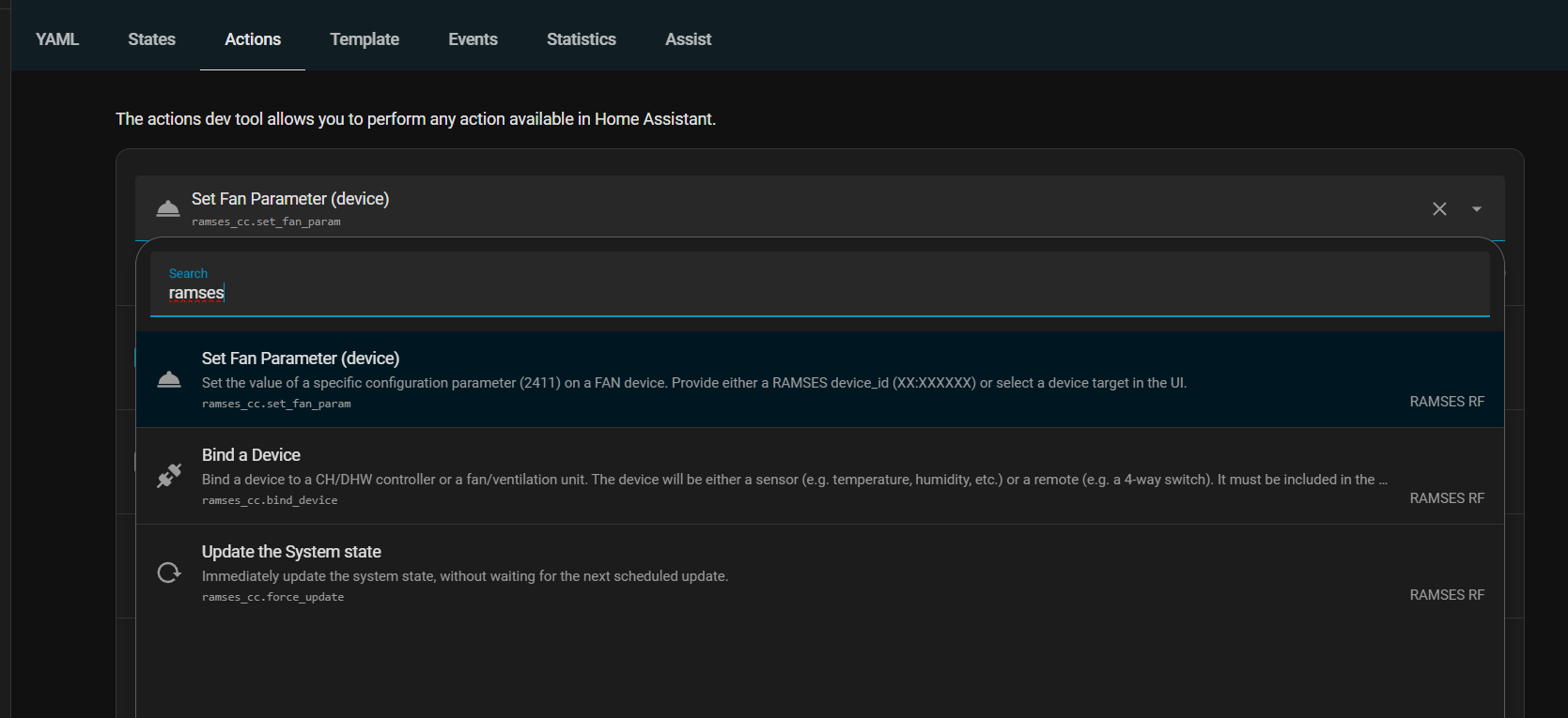

Release 0.51.3 contains changes to how actions are set up.
I’ve created issue 424 on GitHub to investigate. I do not see these symptoms on my own Fan setup, though; lots of actions available.
  • Try to restart HA once more and watch for errors in the System > Log section.
  • Can you add your HomeAssistant system log as a comment under that issue? There might be some useful warnings in there.
  • Also add your ramses packet.log (about 1 hour) as a file (drop it on the edit pane).
  • Your previous Ramses version was 0.52.5, from HACS?
  • How is your gateway dongle connected; MQTT or USB?
  • confirm that reinstalling 0.52.5 in HACS (Ramses RF > 3 dots menu > need different version popup) does not show the same problem.
Version number typo; it should read:
Release 0.53.1 contains changes to how actions are set up.
This broke some services.
We’re working on a fix, to be released later today.
Did the ways remotes work also change? Because I was using automations for when humidity were rising/lowering inside the bathroom to send a command to increase the Fan to to full speed, but that command does not appear to be working anymore
Just out on HACS: Ramses RF 0.53.3, a pre-release version that isn’t automatically showing up. Select it in HACS > Ramses RF > Download > Need a different version drop down.
It contains substantial improvements to code structure, services and asyncio use of the ramses_rf library.
Please try it out and report your findings.
