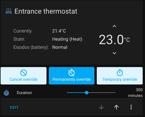

I don’t know if someone is interested in, but I created some customized lovelace cards using
simple-thermostat and service override to custom scripts
custom button:card and custom-slider
and two simple scripts that I created, which are used to forward the commands to evohome_cc
Here is a small example. If there is interest I can post the scripts and lovelace setting.
Screenshot 2021-04-15 at 21.39.38
Looks nice, I’m interested! Perhaps create a page on the wiki Home · zxdavb/evohome_cc Wiki · GitHub ?
@kardiologia Amazing! Please do put it on the wiki if you could.

I created the wiki for the customized lovelace cards.
I hope it will be helpful.
