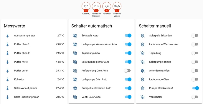

I managed to integrate my uvr1611. I have one question: is it possible to see the current state of automated switches? I see if a digital switch is set to automated, the corresponding manual switch is always off. In the web frontend of the bootloader I see „AUTO/AUS“ and „AUTO/EIN“, regarding to the current state. I would like to set up an automation quering the state of „Anforderung Pelletkessel“ to check running out of pellets.
Regards and a happy new year
Georg
@nielstron
Since I had no experience with python and HA yet I needed some time to find the solution myself.
I changed the “switch.py” so that the icons show correct state.
I also added “mode” to the automatic switches as “EIN” or “AUS” and a new attribute “fullmode” to both switch types.
A bit tricky still is that there is no immediate update of the state if you change a switch. Maybe I’ll find out that later. This is my version:

thanks for your work and regards
Georg
blnet_details

@bulli - Thank you for your update for “BLNET” - Now I see the status of my heating/BLNET digital sensor - it is already showing up on my dashboard !
@nielstron - I really appreciate your integration of @bulli’s updates - I verified the problem with temperatures/values below 0 with the latest source:
