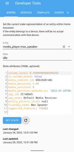

group_State: '{{ states(''media_player.home_group'') }}'
mediaplayer_State: '{{ states(tts_entity) }}'
mediaplayer_volume_level: '{{ state_attr(tts_entity,''volume_level'') }}'
mediaplayer_media_content_id: '{{ state_attr(tts_entity,''media_content_id'') }}'
mediaplayer_app_name: '{{ state_attr(tts_entity,''app_name'') }}'
mediaplayer_Source: '{{ state_attr(tts_entity,''media_channel'') }}'

hi @ghassan,
Looking for some help here. Any idea if this will work with YouTube Music? It’s clear the script is working (based on the state of the device), but it doesn’t resume playing music.
Here’s the state before and after the script:
Before:
Hi @shanf67,
Looks like the source is restored correctly but the most basic which is the state is not.
We verify that if you manually start playing on the device and check if it plays the correct, media. Please do the test and tell me the result.
The script has been under development and is shared here in different versions.
From which post nr did you copy it?
Even if I attempt to play again manually, it doesn’t work. I’m assuming because the app changes.

Hi @shanf67 ,
I guess you are right, this is very likely because we miss to backup and then update some important attributes.
I am not sure which of these exactly but probably the app_id / name
But don’t worry this can be done. We can backup and restore all these attributes.
To be able to do that, I have installed and use a python script, and I do it successfully in my version of the script. But i just cant remember which script it is and where to find it.
I’ll search for it and get back to you
In the meanwhile you can work identifying which attribute we still need to adjust.
You can start changing the app_Id
you can do that from the developer tool, in the state attributes window, and then hit “Set state”
Then try to start playing from the lovelace or any other place you can control the media_player and see if it works.
if not, then try another attribute and so on.
Stay tuned
