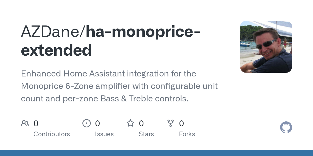

I’ve been working on the Home Assistant Monoprice 6-Zone Amp integration and made a few targeted improvements:
• Added a configurable unit count (1–3) so HA only creates/polls zones that actually exist
• Exposed per-zone Bass & Treble controls using native HA number entities
• This eliminates polling of non-existent zones, which was causing delays and inconsistent behavior
• Result is faster, more reliable control and a cleaner UI
No hardware changes, just better use of the existing serial protocol.
If others are interested, I can publish it as a custom integration or submit it upstream.
I’d be in be interested in trying it out.
Can it limit the zones in use on a single amplifier? For example I’m currently only using 3 of 6 zones. If so, I’d give it a test.
Right now this only limits zones at the amplifier unit level (1–3 units), not individual zones within a unit. I did consider per-zone enable/disable, but that felt like overkill for the initial change.
The main driver for this work was a noticeable performance hit once Bass/Treble entities were added - polling non-existent zones amplified the issue. Limiting units solved the real problem without adding a lot of extra configuration complexity.
That said, if there’s interest, adding optional per-zone enable/disable could absolutely be explored.

I’ve been working on extending the Home Assistant Monoprice 6-Zone amplifier integration and wanted to see if others are interested in testing it.
What’s new:
  • Configurable number of amplifier units (1–3) during setup and via Configure
    → HA only creates and polls zones that actually exist
  • Added per-zone Bass and Treble controls as native number entities
  • Cleaner UI and improved responsiveness by avoiding polling non-existent zones
No hardware changes and no protocol changes - this just exposes functionality the amp already supports and avoids unnecessary polling.
I’ve been running this locally and via HACS with a single 6-zone unit, but it should also work for 2- and 3-unit setups. I’d especially love feedback from anyone running multiple chained amps.
Repo (HACS custom integration):
Install via HACS:
  • HACS → Integrations → Custom repositories
  • Add AZDane/ha-monoprice-extended (Category: Integration)
  • Install and restart HA
This is a drop-in replacement for the core Monoprice integration (same domain), so existing entities and configuration should carry over.
Happy to adjust things or clean it up further if there’s interest - feedback welcome.
Note: If you’re upgrading from a previous setup, you may still see device entries for higher-numbered zones. These won’t have any entities and are not polled - it’s just Home Assistant retaining old device metadata. Fresh installs will only create devices and entities for zones that actually exist.
