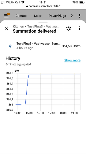

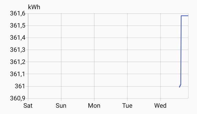

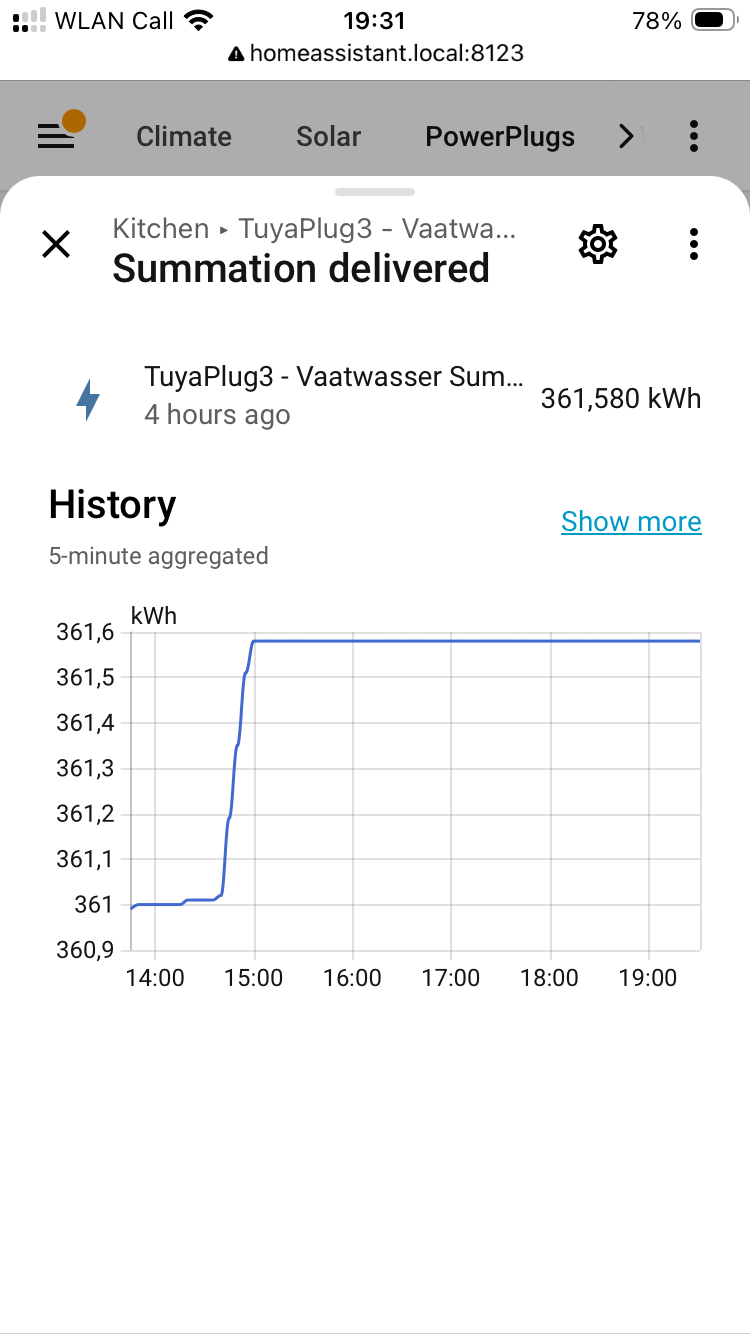

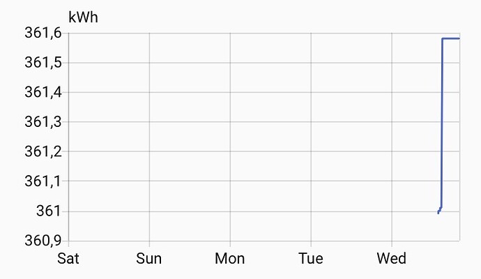

I followed these steps to remove the long term statistics of a specific sensor entity.
Then recreated the entity(with the same name) at least 10 days later…
And see the long term values come back as never deleted…:smiling_face_with_tear:. I call it a bug, while it says it will delete the long term statistics.
