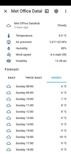

Have the rest temperature sensors, forecasts, precipitation and even a description as a text, but I think they are all useless things, only the forecasts and temperatures should serve.
I have the forecast for the next 5 half days (day 1 morning - evening day 2 morning - evening day 3) then two full days. This will be feasible to align it by comparing the current date with the date of the REST sensor, but it will be a future modification to be given. First I need to figure out how to fix them
You don’t "insert that code " — you have to build the data structure from the available forecast data. Look again at my post:
… where I build the hourly forecast data structure in the template weather entity:

You need to do the same to get whatever your input looks like into the same structure.
@Troon I read everything and did a lot of tests, but my inexperience and my bad relationship with English are perhaps making me go the wrong way.
I didn’t understand, but in the end your method creates a weather entity, or creates a sensor with the same data, but not exactly a weather entity? just to understand, because I’m reading everywhere that the weather forecast entity is not supported, so I don’t understand
It creates a Template Weather entity, which should be the same as a “real” weather entity. Here’s what mine looks like:
But in this way, will you not be able to use cards already made specifically for correct weather entities? I’m trying to understand🧐
Yes you will.

this really escapes me and I don’t understand, I think I’ll have to give up for the second time
forecast_hourly_template: >
{% from 'met_office_codes.jinja' import code2ha %}
{% from 'direction.jinja' import dir %}
{% set dh = state_attr('sensor.local_datahub_hourly','timeSeries') %}
{% set ns = namespace(forecast=[]) %}
{% for ts in dh -%}
{% if ts['time']|as_datetime > now() %}
{% set tsd = { 'datetime': (ts['time']|as_datetime).isoformat(),
'condition': code2ha(ts['significantWeatherCode']),
'precipitation_probability': ts['probOfPrecipitation'],
'wind_bearing': dir(ts['windDirectionFrom10m']),
'humidity': ts['screenRelativeHumidity'],
'pressure': ts['mslp'],
'uv_index': ts['uvIndex'],
'temperature': ts['screenTemperature']|round(0),
'apparent_temperature': ts['feelsLikeTemperature']|round(0),
'wind_speed': ts['windSpeed10m']|round(0) } -%}
{% set ns.forecast = ns.forecast + [tsd] -%}
{% endif %}
{% endfor %}
{{ ns.forecast }}
For starters, you need to make a template weather entity. You just copied and pasted what troon wrote into your configuration.
yes exactly, I copied and pasted saying “I don’t understand this thing”. I understand that I have to create a weather template entity, I will still have to study to understand how
How have you created any other template entity? Note your file has other examples of other templates. e.g. your binary sensor starts with
And the template weather documents show:
Yet you just copied and pasted
thanks again for your patience, little by little I hope to succeed!
