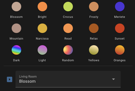

Ok I ended up doing it this way:
Using RGB Light Card to show some simple buttons to activate scenes, example here:
      - type: custom:rgb-light-card
        justify: around
        label_size: 10
        colors:
          - type: call-service
            service: hue.activate_scene
            service_data:
              transition: 3
              entity_id: scene.living_room_mountain_breeze
            label: Mountain
            icon_color: "#BD9A8E"
Then the input select in the UI like this:
      - type: divider
      - entity: input_select.scene_living_room
        icon: mdi:play-box
        tap_action:
          action: call-service
          service: script.activate_scene
          service_data:
            room_id: living_room
            transition: 3

I’m 40 years out on scripting/programming at this point.
What value did you set for
value: “{{ option }}”
option is the value, it’s a variable that holds the value from what is selected from the frontend or from a script action.
