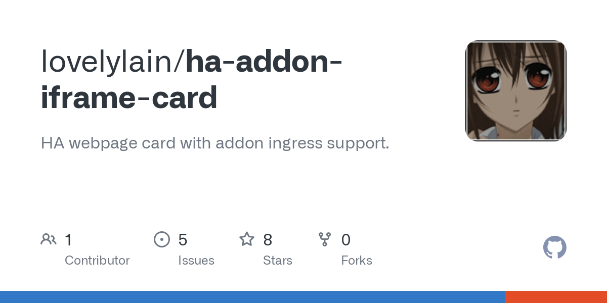

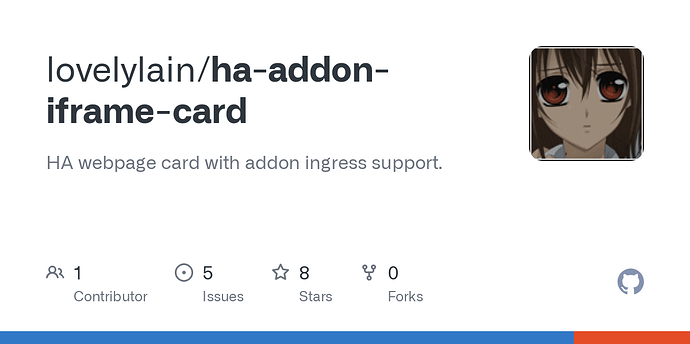

you can try hass_ingress integration.
you can try hass ingress integration, it provides these features:
- Ingress function similar to Hassio Ingress. (option: work_mode: ingress)
- Sidebar function similar to Panel_iframe. (option: work_mode: iframe)
- Work with nginx auth_request for backend services can’t be proxied by ingress. (option: work_mode: auth)
- Additional http headers passed to the backend service, such as
authorization
andhost
, so that we can access the external resources without extra login. (option:work_mode: ingress
header: {map}
