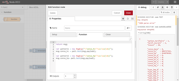

Thanks to your message I have installed node-red and build your test => Really simple to use
Thanks to this test, I can confirmed that JSON doesn’t work due to zero value
Great.
Now between the http node and debug node insert a function node.
In the function node add the following: (keep the line that is there and add this above)
var pattern1 = new RegExp("\"conso_hc\"\s+:\s+(\d+)");
msg.conso_hc = patt.test(msg.payload);
var pattern2 = new RegExp("\"conso_hp\"\s+:\s+(\d+)");
msg.conso_hp= patt.test(msg.payload);
Now click on the inject again after you deployed it.
This should mean the message should include the two values as separate values.
You will see that as msg.payload and the arrow you clicked to expand it (don’t do that this time), but below this there should be a msg.conso_hp and msg.conso_hc.
If I didn’t screw up…
Seems not working but perhaps I did something wrong, I’m beginner in HA & Node-Red.
Sorry I was unclear.
The return msg should be the last line
Ok, I still got an issue.
My bad again…
msg.conso_hc = pattern1.match(msg.payload);
msg.conso_hp= pattern2.match(msg.payload);
return msg;
Many thanks for your time ! I really appreciate.
I think we are no far from the result but unfortunately your last proposal is not working too.

And here are the new screenshots:
