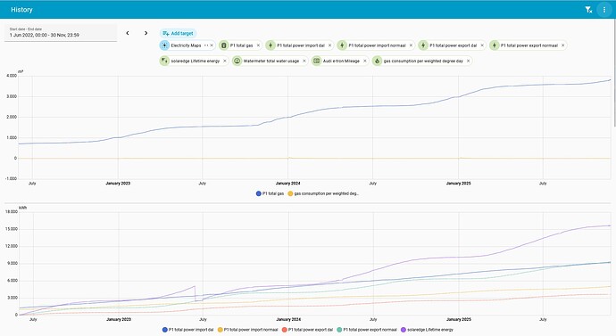

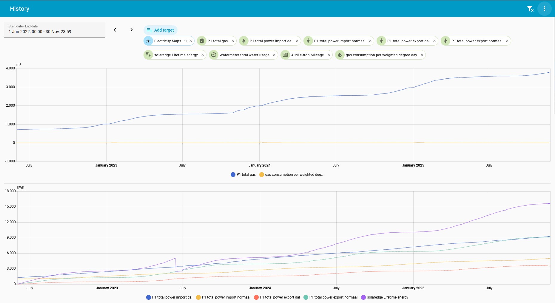

MariaDB import works perfectly now. 7 years of energy and solar history imported. No idea what I will do with it now though, besides looking at it :wink:
Thanks for your efforts!
