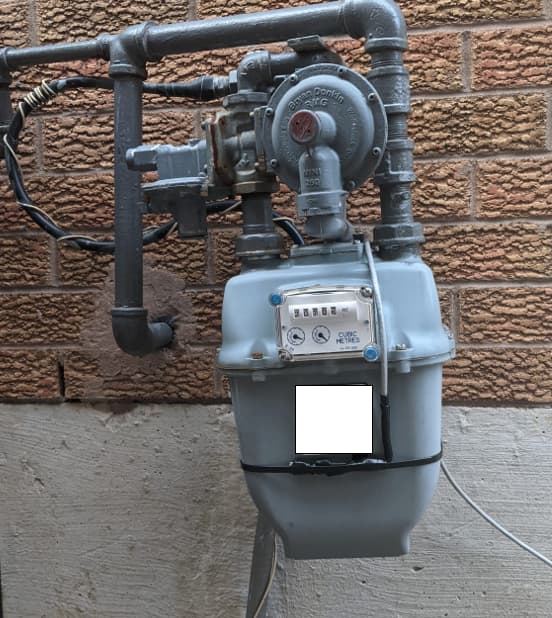

The following seems to work pretty well with my Enbridge gas meter and the cost to implement the sensor is not too expensive. Works well on water meter in Toronto as well (Neptune N10).

Have you mounted the QMCL on your Enbridge gas meter. Did the meter reader person give you trouble. If possible can you upload a picture
Thanks

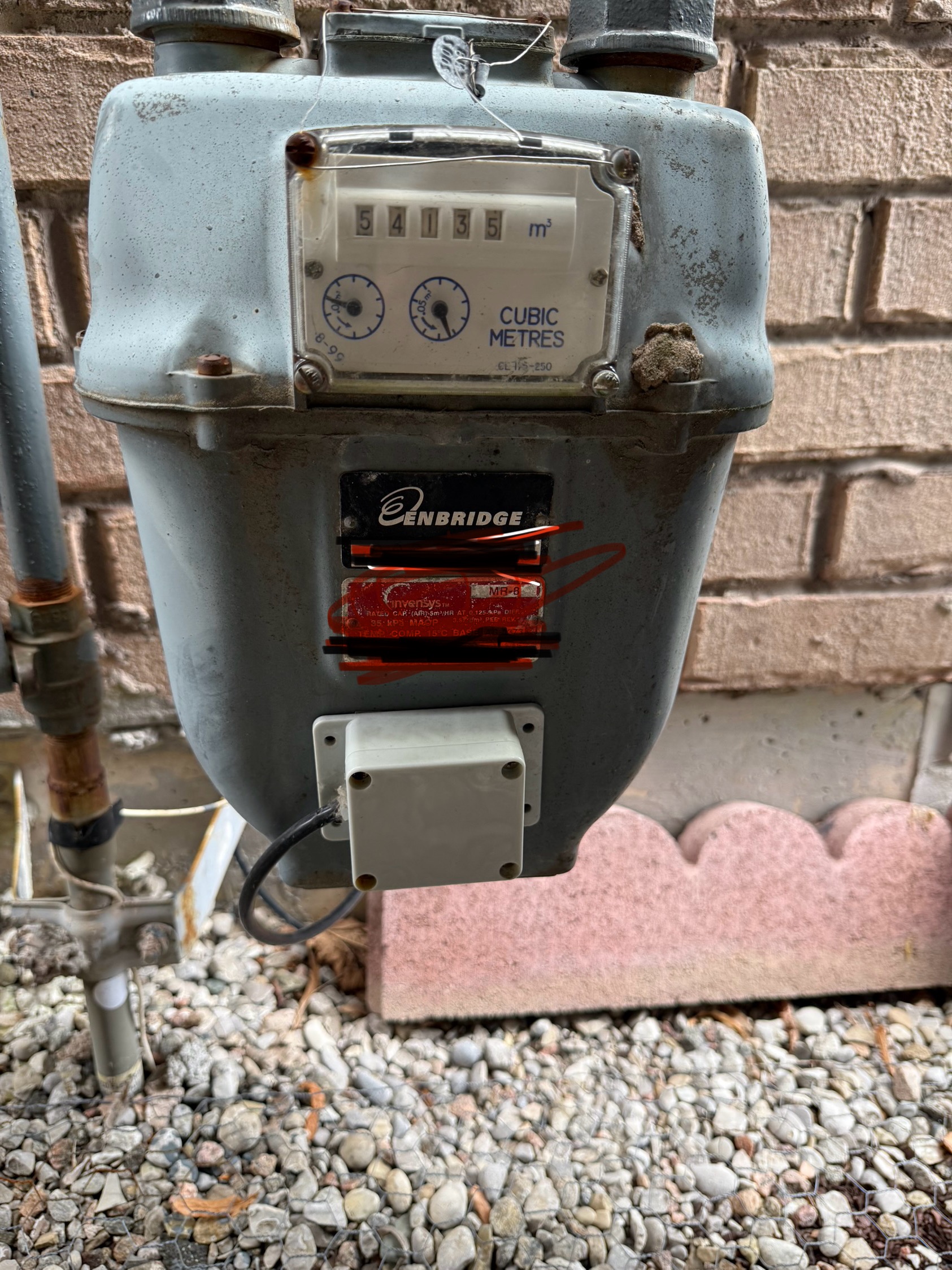

Replying with a photo of my install using that same integration. No concerns flagged from the utility for me. At least not yet. :slight_smile:

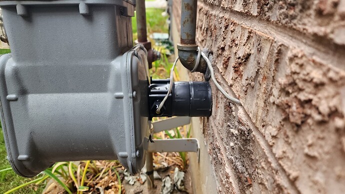

The sensor is in the waterproof box, and the two round things on the back are just used to hold the box against the meter.
Thank you very much. Genius – putting it behind the meter rather than the front. I have the same meter as shown on the Github repo. I am guessing whether I mount on the front or the back wouldn’t make a difference. Natural Gas is the last thing left to monitor.
See below, no complaints from meter reader:
Thanks for the picture. My meter is the same as yours do you think if I mount it on the rear of the meter in the same spot will I get the same accuracy?
Lot of factors on that such as sensor sensitivity and external interference. I recall trying it in the back but ran into some issues but that may have been due to initially using thermostat wire instead of Ethernet. Only way to know is try it that way and if not working move to front.
