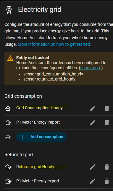

ok, also new energy meters here, i want to have the new entity names in ùy energy dashboard, my old gas meter is still online
if i rename my old gasmeter
like sensor.gas_meter to sensor.gas_meter new, it doesnt work, and my dashboard complaints statistics cant be found …
how can i keep my old history, using new entity names? why are statistics not renamed with the old sensor that i rename?
Which integration provides your entities? Do they have the correct state class by default, or did you add it via customisation?
i had before the smappee, now i use homewizard
deleted the integration, left the entities still there, now i see this, but its ok
renaming didnt work…
the hourlys were the old ones, i just leave them there now…
