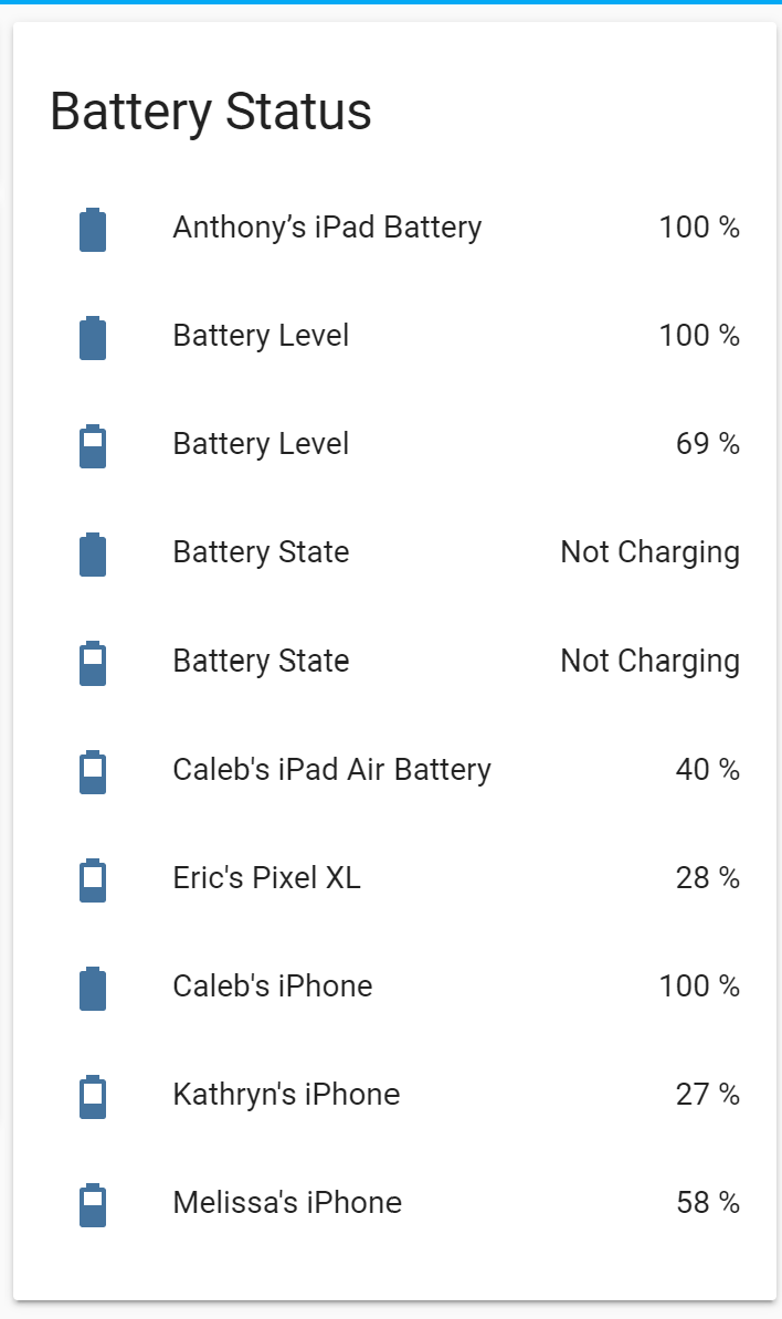

Last night I decided that I wanted to monitor the battery level on my boys’ ipads. So I install the IOS app on each of them. Unfortunately it appears that the current version of the app creates a handful of sensors for each device, see below.
The code to update group.battery_status now picks up sensor.battery_level and sensor.battery_state, see below.
For now, I’ve decided just to disable these sensors by going Configuration > Integrations > Mobile App: {device name} iPad and toggling them disabled in there. It’d be nice if these sensors could be ignored or skipped over. Especially since one of them doesn’t even report a percentage, as seen below*
*Yes, the battery level’s don’t match perfectly for Caleb’s ipad, that’s next on my list of things to explore.
