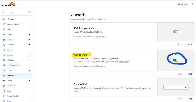

I spent days on this trying all sorts of configs with cloudflare & caddy and in the end (only hours ago) my problems were due to a simple setting in cloudflare (or lack thereof)…
It had been turned off 2 months ago (why I don’t know) but turning it on enabled the cloudflared tunnel to “just work”, plus without any caddy reverse proxying on the external connections. I had narrowed it down to websockets as there were numerous posts about NPM requiring websocket header upgrade but in caddy2 that’s enabled by default now. Doesn’t work though if an external entity has websockets turned off before it even gets to Caddy! After that, the mTLS cert method on my phone was easy…

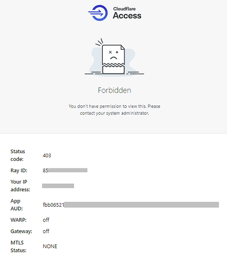

When I test access via the HA App I get the following forbidden access screen
and when I try to debug using the Brave browser I get a slightly more informative error
When I went back to check my Zero Trust → Access → Applications settings I can see that under the Authentication tab it has automatically enabled the other Identity providers that I have setup for domain.
If disable/deselect all these identity providers they are automatically re-enabled.
Any pointers on where I’ve made a mistake would be greatfully received.

There not does not appear to be a way to de-select indentity providers. If you de-select Accept all available identity providers
, it appears that at least one has to be manually selected.
Try selecting Service Auth
rather than Allow
for the Action
Were you prompted to select the local android certificate when you first connected the app via ha-mtls?
Is the Valid Certificate policy the only policy in application ha-mtls?
I am back-ending three different public subdomains through my Home Assistant application into HA and I have two separate policies - 1. Service Auth for certificate and 2. Allow for Email OTP:
From my laptop remotely without a certificate to the general subdomain I get the CF login window.
From my phone to the subdomain for it to use i was prompted for a certificate and now it just works.
I can all get extremely confusing pretty quickly and trying to figure out CF’s order of processing and what goes where and when is not easy. I still don’t have the Alexa or Alexa Media Player working yet…
Thanks for your suggestions. I changed my policy to Service Auth
and it still didn’t work.
After reading around some more I found that the step I was missing adding my domain to the hosts lists SSL/TLS → Client Certificates
That’s fabulous news! I just checked my Client Certificates and all 4 of my hosts are listed.
