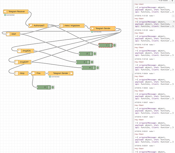

Hi @Domoticon
I’m trying to use the flows at first post, but I get a strange behaviour
This is my example
and this is how is defined the Telegram Receiver node
This is the Menu node
This is just for test.
When I send the /start command I get the menu twice and if I send the /stop command I don’t get the end mesage, but I still get the menu again.
17
What is strange is that the only debug node where I get the message is # 1 as in the first image, it seems that does not go thru the other ones.
Any suggestion?

1 - If you use a Telegram Sender node, enable the Track and Pass Through options.
2 - Use for every command a Telegram Sender node and connect the output to all the Command node inputs (loopbacks). This is different from the example in the first posting, but I experienced the same issues/difficulties and that is how I solved it.
3 - In your example, make sure the Telegram Sender node connected, at the end of the /stop command, has disabled the Track and Pass Through options. This to make sure you can exit the Telegram tracking. Be aware if you don’t do this it can be resulting of being stuck in the Telegram tracking loop.
4 - if duplicated commands occur, you could use a trigger node between the command which is duplicated with options set to:
Send: nothing
then: wait for, 1, Seconds, extend delay if new message arrives
then send: the latest msg object
Handling: all messages
FYI, this my noob solution…
Hope this helps.

What is the grey node with right arrow? It seems a subflow or what?
The yellow right arrow is a telegram sender node, right? What are the parameters?
03
That are Link input and output nodes. I use this to keep the flow ‘shows’ as clean as possible, otherwise it will show all loop-back lines. If you click on it, it will show the connections, if you don’t click it if will not show the connection lines.
You don’t have to use those, it’s just a personal solution I use.
