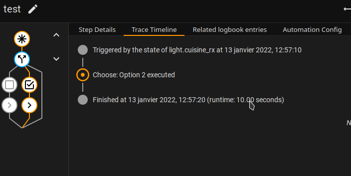

The automation script works well but I have an huge latency (Min: 6 seconds, Max: 10 seconds)
Of course, from the frontend I don’t have any latency.

Regarding the homeassistant logs, the script has been executed in 1 second but for real I have to wait 3 seconds. I think this time will be incompressible…
