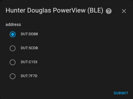

4. Reboot HA
5. Add blinds to the component and verify you can see the status of the blinds
