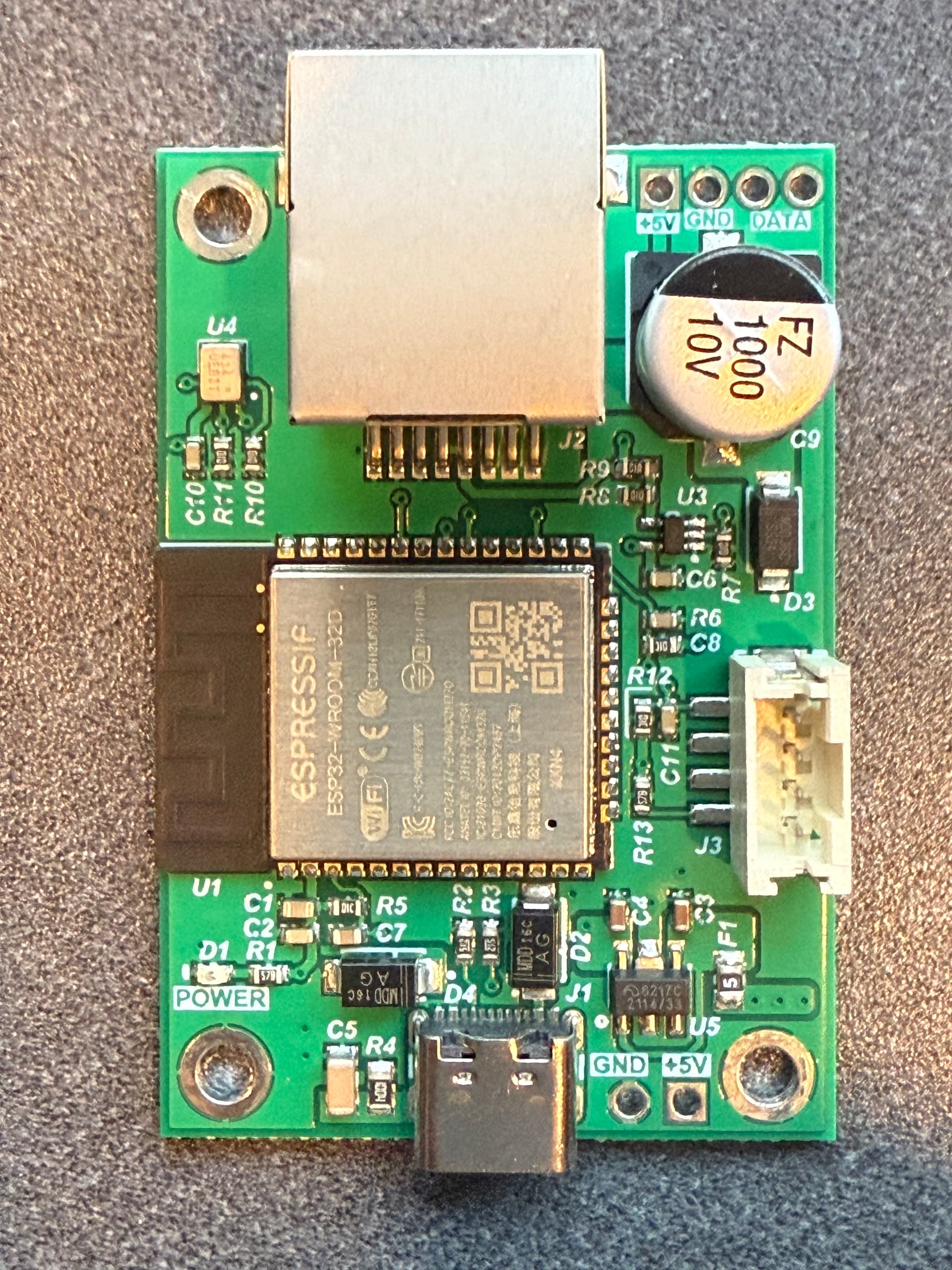

Nice easy connection to the data pins, I think I’ll just flash mine with standard WLED when I get home. It seems that the HyperCube people aren’t going to do anything soon.

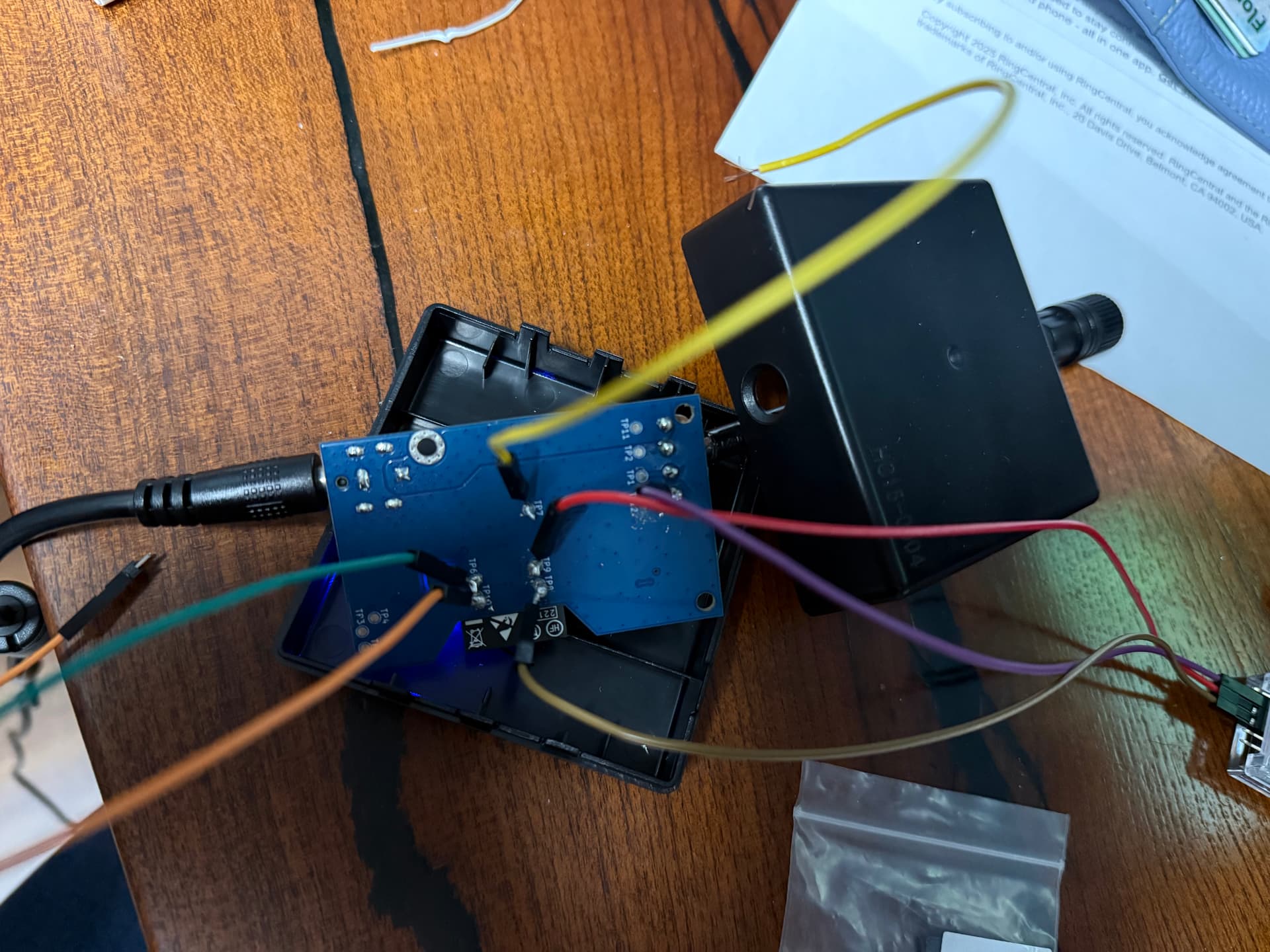

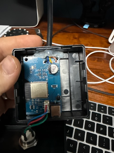

I recently swapped out the proprietary HyperCube firmware on their ESP32 controller and replaced it with stock WLED. It took me a little experimenting to figure out the quirks of this board, so I wanted to share the process in plain language for anyone else trying it.
When I first cracked it open, I found that HyperCube ships their own locked-down fork of WLED. That meant no easy updates, no OTA, and limited integration with Home Assistant. The good news is the hardware underneath is just an ESP32, so it can run stock WLED once you know how to flash it.

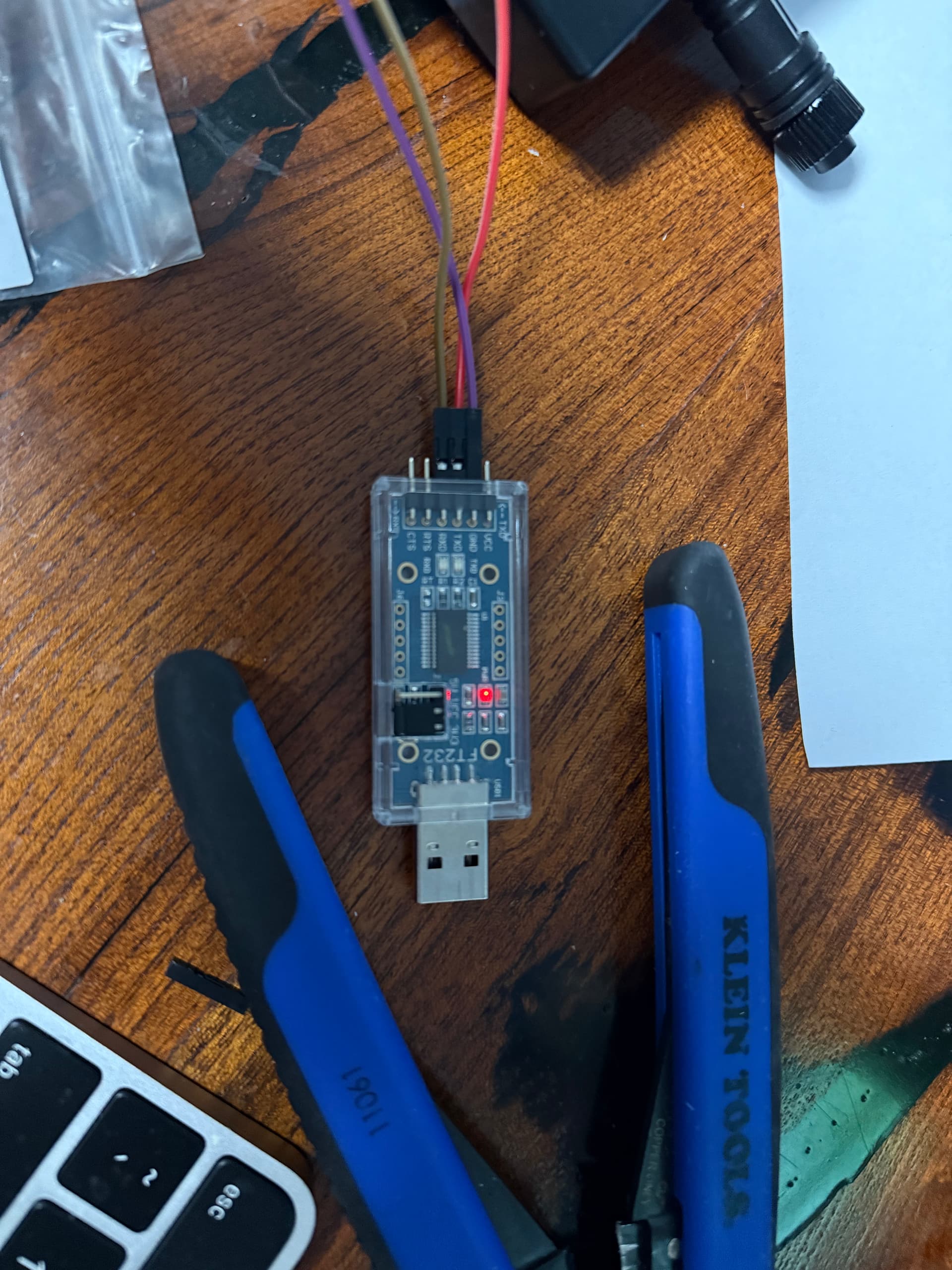

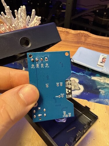

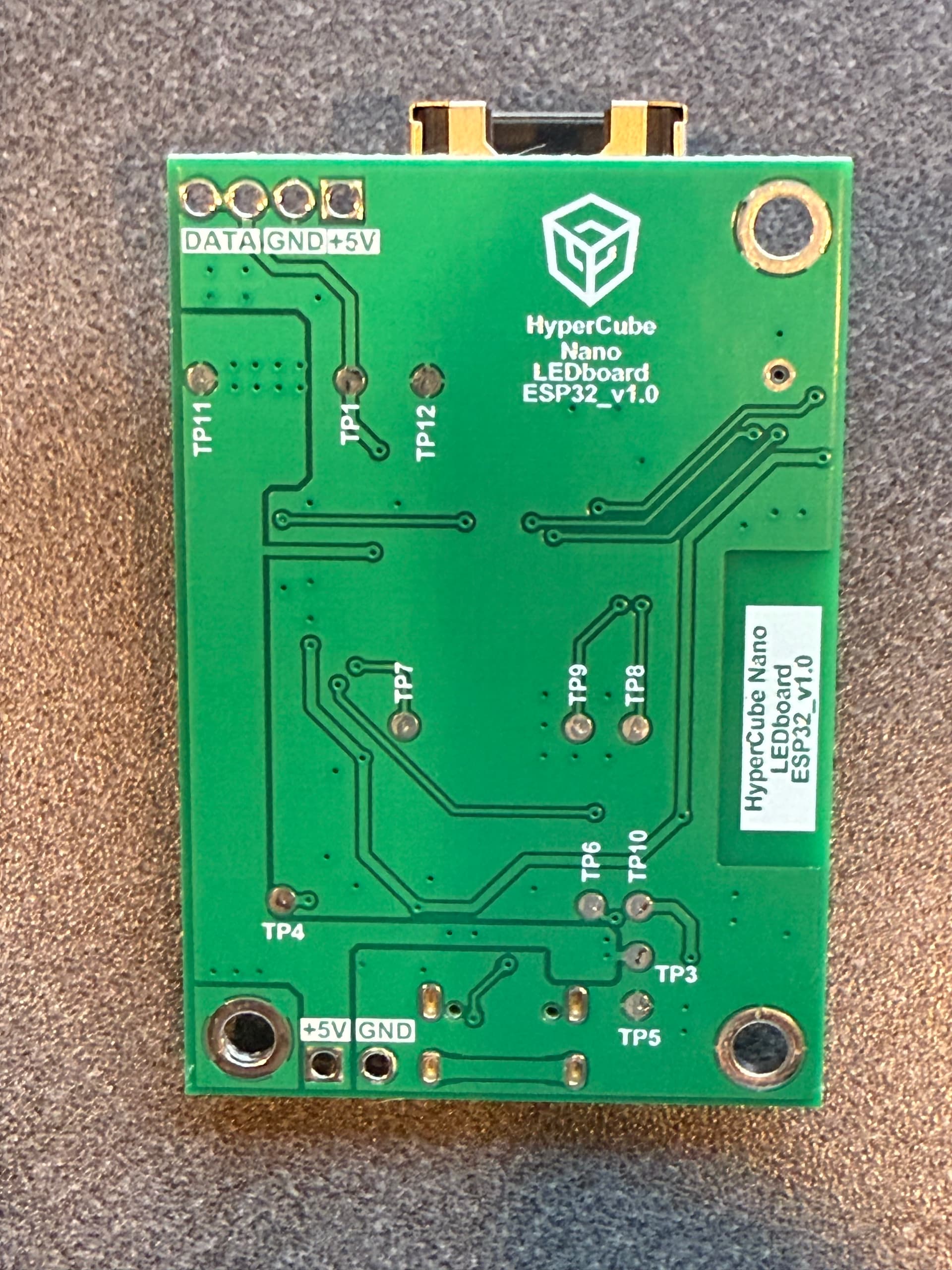

The board has a set of test pads on the PCB that act as the programming pins. On my version of the board the mapping was: TP7 is the BOOT pin (IO0), TP8 is RXD, TP9 is TXD, and TP10/TP12 are ground. I used a USB-to-UART adapter (set for 3.3V logic) and connected TX from the adapter to TP8, RX to TP9, and GND to TP12. You don’t connect the adapter’s 3V3 or VCC line, since the board already powers itself through the 15V barrel jack. It also helps to unplug the LED strips while flashing so the ESP32 doesn’t brown out.
To get the board into flash mode, I held TP7 to ground while plugging the barrel jack back in. After a couple of seconds I released it, and at that point the ESP32 was waiting for new firmware. Rather than fight with esptool and single .bin files, the easiest solution was to use the official WLED Web Installer. In Chrome or Edge you just click “Install,” select the USB serial device, pick ESP32, check “Full install,” and let it run. This writes the bootloader, partitions, and the WLED app all at once. When it finished I disconnected the jumper and power-cycled the board.

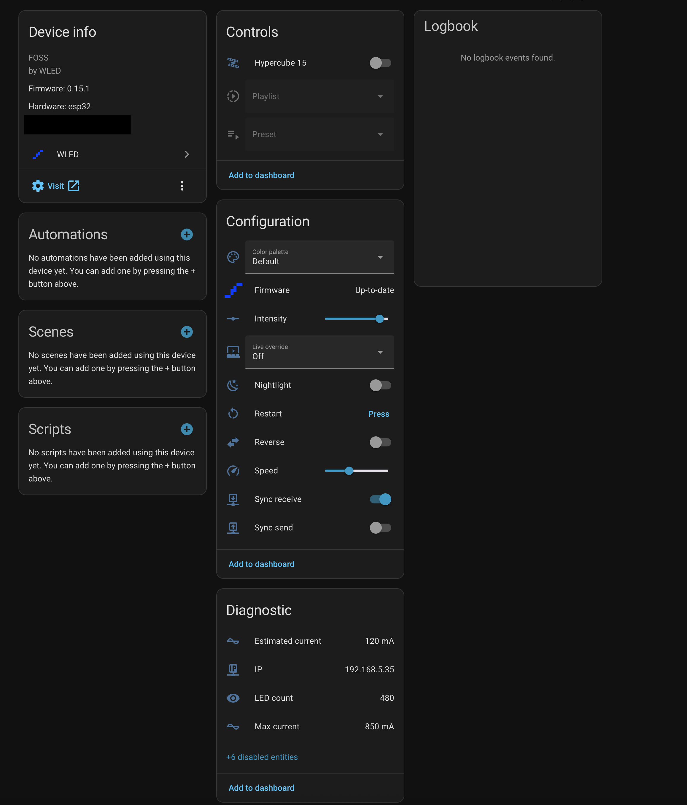

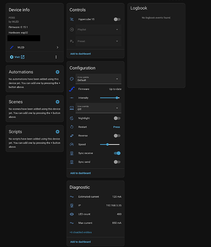

On the next boot the board broadcast a Wi-Fi network called WLED-AP (password is wled1234). I joined it, the captive portal came up at 4.3.2.1, and I was able to enter my home Wi-Fi details. After saving, WLED connected to my network and I could reach it at wled.local. From there it’s just the normal setup: set an OTA password under Config → Security, reconnect the LED power lines, and choose the correct GPIOs for your strips in LED Preferences. Home Assistant picked it up automatically with the WLED integration.
So that’s all there is to it. The hard part was figuring out which pads were which, but once that was sorted the Web Installer made the flash painless. Now the HyperCube controller runs stock WLED, can be updated OTA, and integrates cleanly with HA. No more dealing with the proprietary fork or opening the case again.
I’m still working on getting the sound reactivity side figured out, but the basics are up and running. For reference, this is on the Hypercube 15, which uses 480 LEDs total split evenly across two outputs. In WLED that means setting GPIO16 for the first 240 LEDs and GPIO4 for the second 240 LEDs.
