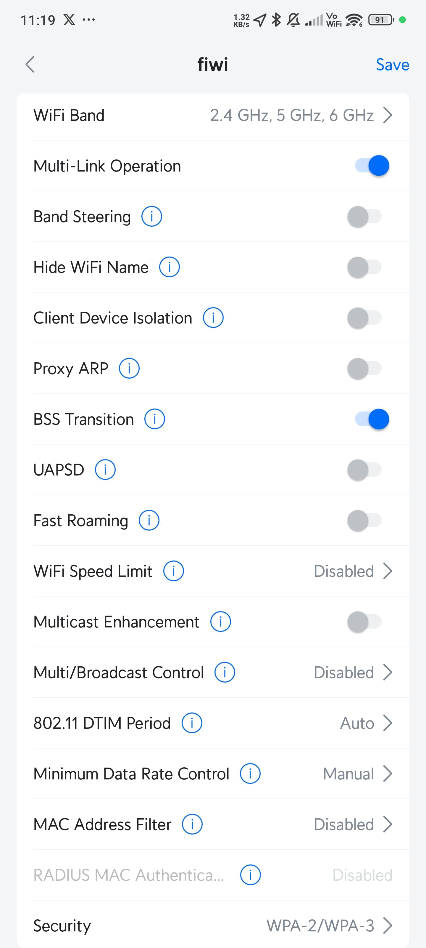

In the unify network settings under:
Settings > WLAN > “the WLAN your ESP should connect” > Minimum Data Rate.
Set it from automatic to manuell and set 2.4GHz to 12

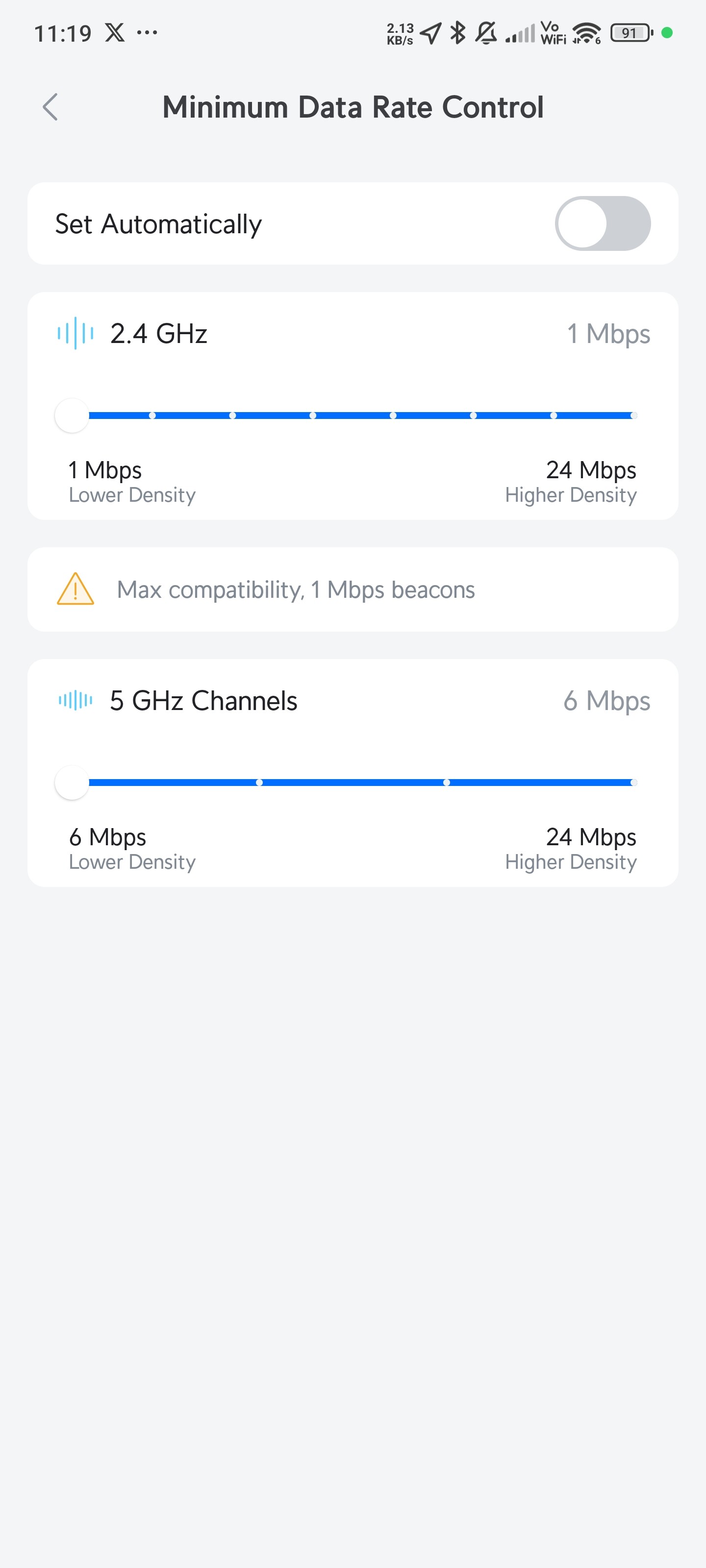

For me 2 of my esphomes imidiatly dropped the network when chnaging minimum rate to 12mbits.
Another issue for me is that I have some outdoor spot controllers on b wifi. Maximum rate on b networks is 11mbits
Just set it to the minimum to allow 1mbps devices:
