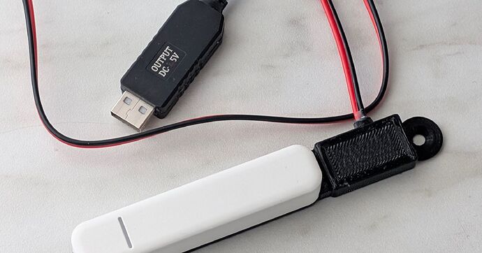

I have been considering adding a second battery. If that works I could create a 3d-printed version with multiple batteries.
Here’s someone who added a live power feed haha
