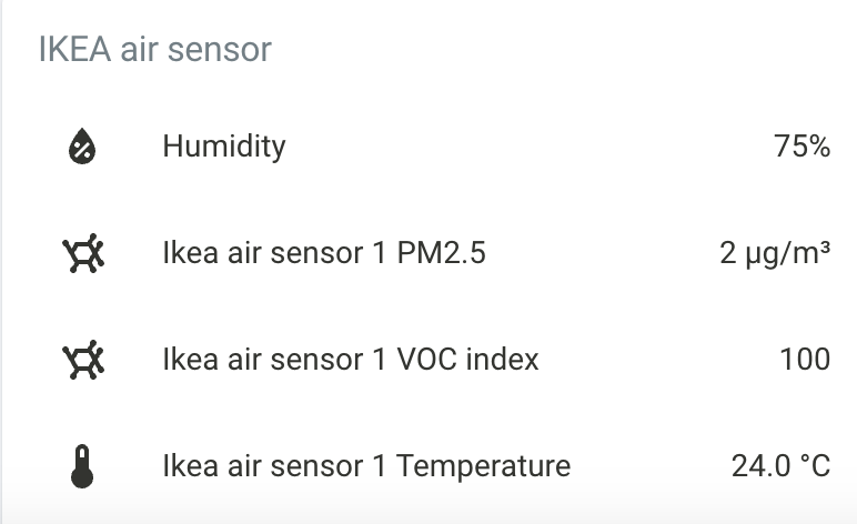

I just wanted to add, since this thread for someone coming into it with some simple questions, is a bit of a minefield… today I bought the Ikea VINDSTYRKA sensor. Some questions answered, perhaps:
  • I use Zigbee 2 MQTT with Home Assistant.
  • You tap the pair button 4 times to find it in MQTT
  • Straight out the box, it shows me temperature, PM 2.5, Humidity and relative VOC
  • I didn’t (need to) add any additional code and I’ve not ran any updates on the device itself
  • See image below (Note: relative COV will take a day to get a baseline)
