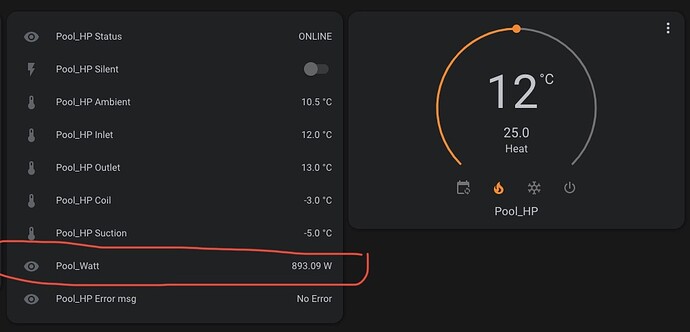

@tvds I couldn’t find Pool_Watt in Danne’s script. Perhaps it’s one of the parameters exposed under codes attributes aggregate. Please upgrade to the latest version.
Thanks @sickidolderivative , just upgraded to the new version. Indeed I can see the code attributes now. Great work!
@dst6se
Any idea what the pool_watt is representing? It seems to be the actual power usage of the heat pump? Is that correct? How did you get that value?
@tvds Sorry, thats not a part of the integration , I have a 1 phase sdm230 modbus meter to get the correct power usage !
@dst6se thanks, that’s clear :wink:

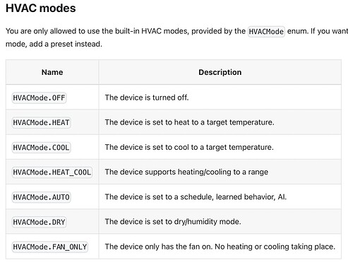

I think that’s because only the “HVAC mode - heat/cool/…” is used and not additionally the “HVAC Action - heating/cooling/…” of the corresponding climate entity.
HVAC mode:
HVAC action
The advantage is that you immediately have an overview of the status of the climate entity:
In the example, some of them are in cooling mode. In case it’s heating, the icons show orange. However the color of the climate entity from the Aqua Temp is always in the standard (idle) color.
