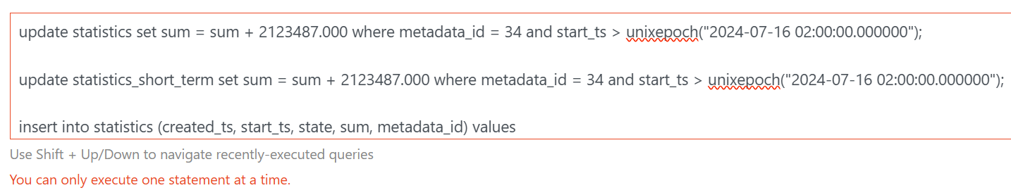

Trying to import my gas data from Domoticz but keep getting this error. Anyone any idea?
Split the lines and run then one by one.
That indeed worked! Thanks @Xenomes
When entering all the lines as an individual query did the trick.

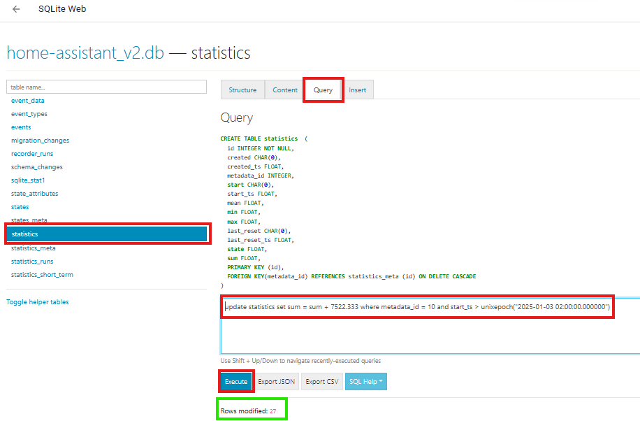

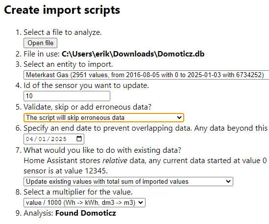

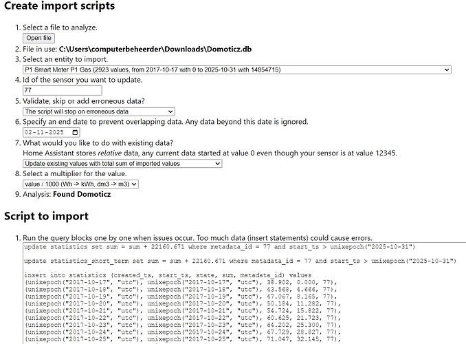

extremely grateful for this tool. I just made some screenshots that even allow the not so gifted SQL users to use this tool.
Instead of running the query, just go to the SQL Web tool and find the required ID’s:
Then load your database, select the Domoticz DB file and use the ID’s found before. This will result in this output:
Image 2

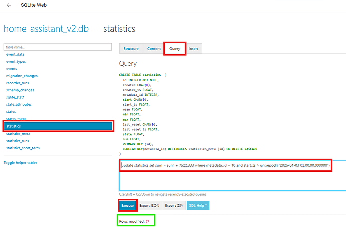

For each of the entries (3 in total) go to the SQL Web tool, select the appropriate table and, go to the query tab, paste your data & click execute.
Image 3,4,5
Repeat the same steps also for the other ID’s (I have 3: Gas in M3, Electricity Low in Kwh and Electricity High in Kwh.
Result: A very happy me !

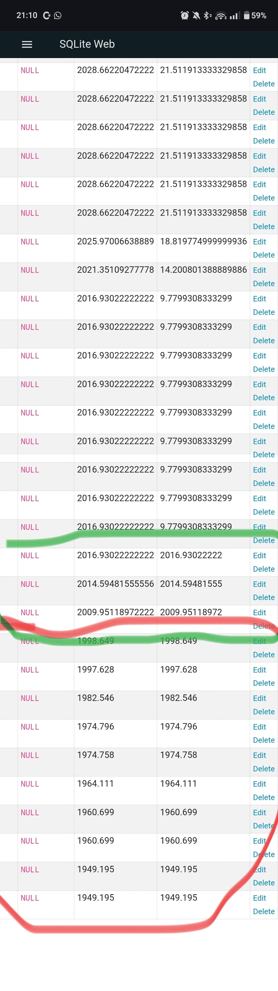

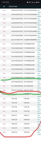

Below, red marked area is imported data into the database, that data is also correct in HA.
Problem is once new data is added the sum is different. And I get a negative -2000 value on that day.
After the -2000 (not exactly 2000 by the way) data shows correctly again. But at weekly/monthly/yearly table I will always have -2000 less kWh displayed.
The green marked area I did change the sum and then the -2000 disappears also. But once new values get added I got -2000 again.
Long story short, anyone knows how to fix it?

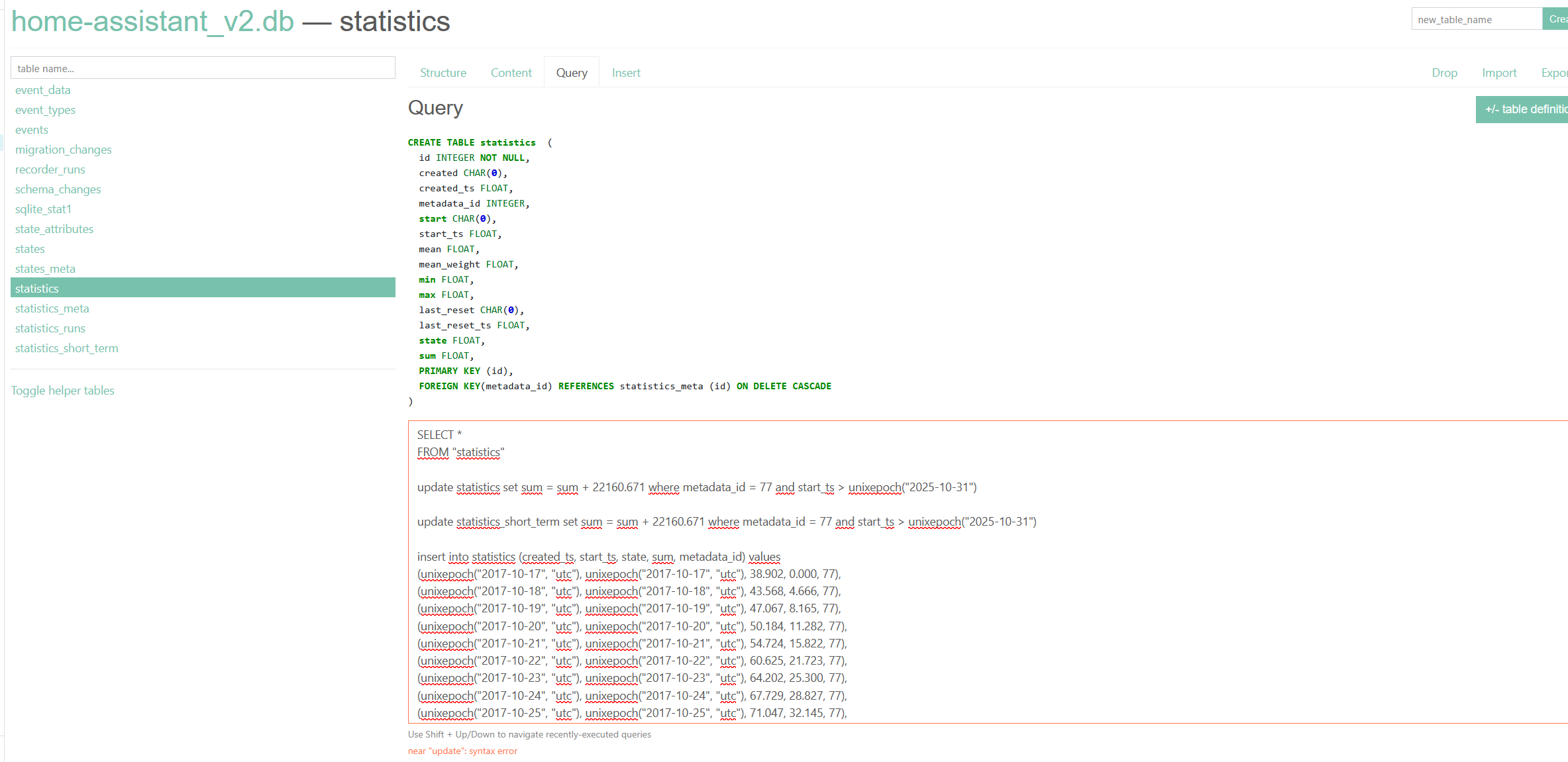

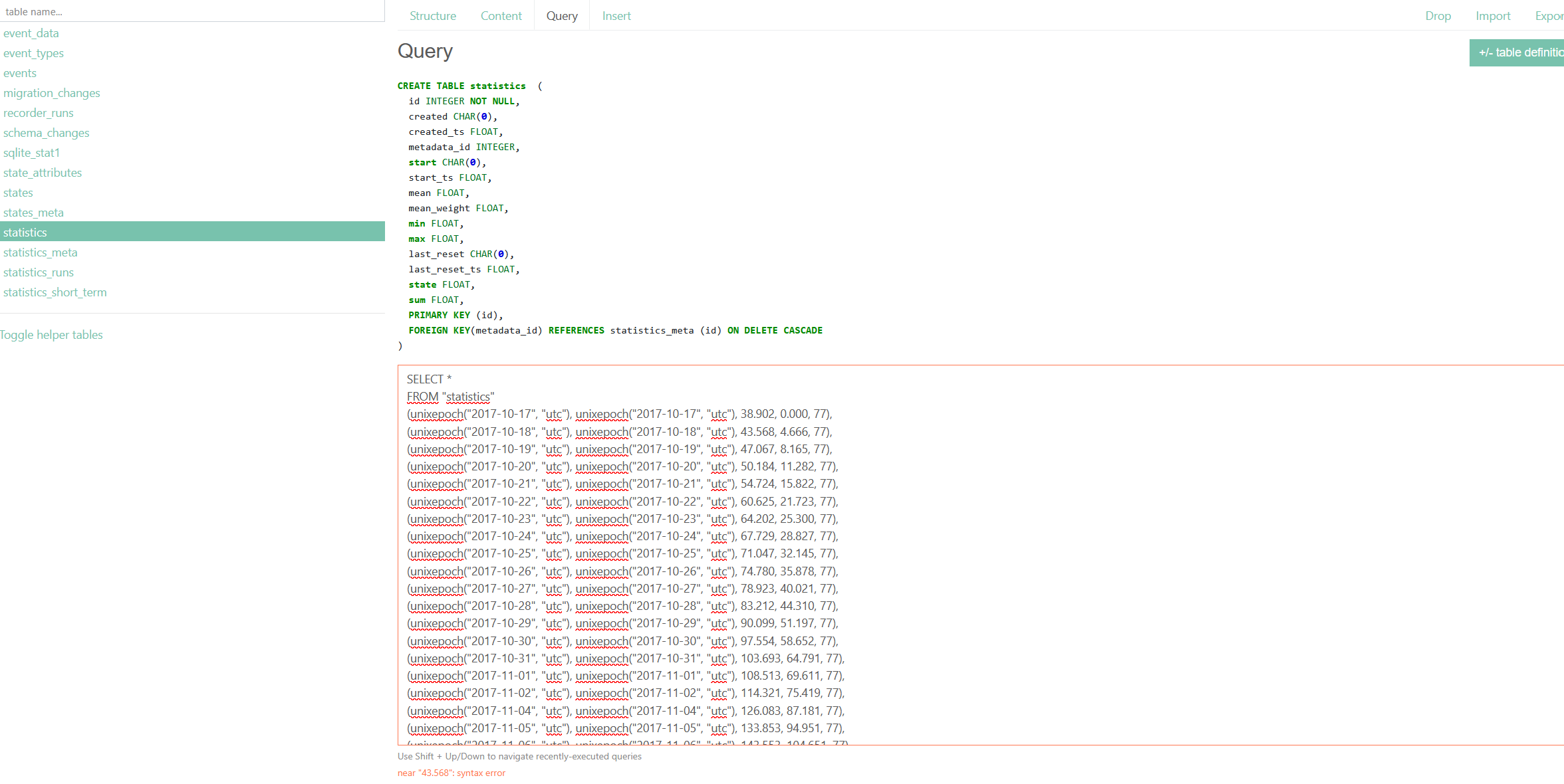

Hello, I am trying to transfer the p1 gas meter data from Domoticz to Home Assistant, see images, something is wrong, anyone have any ideas?
it has been solved see here https://gathering.tweakers.net/forum/list_messages/2212238/0 it is in Dutch
