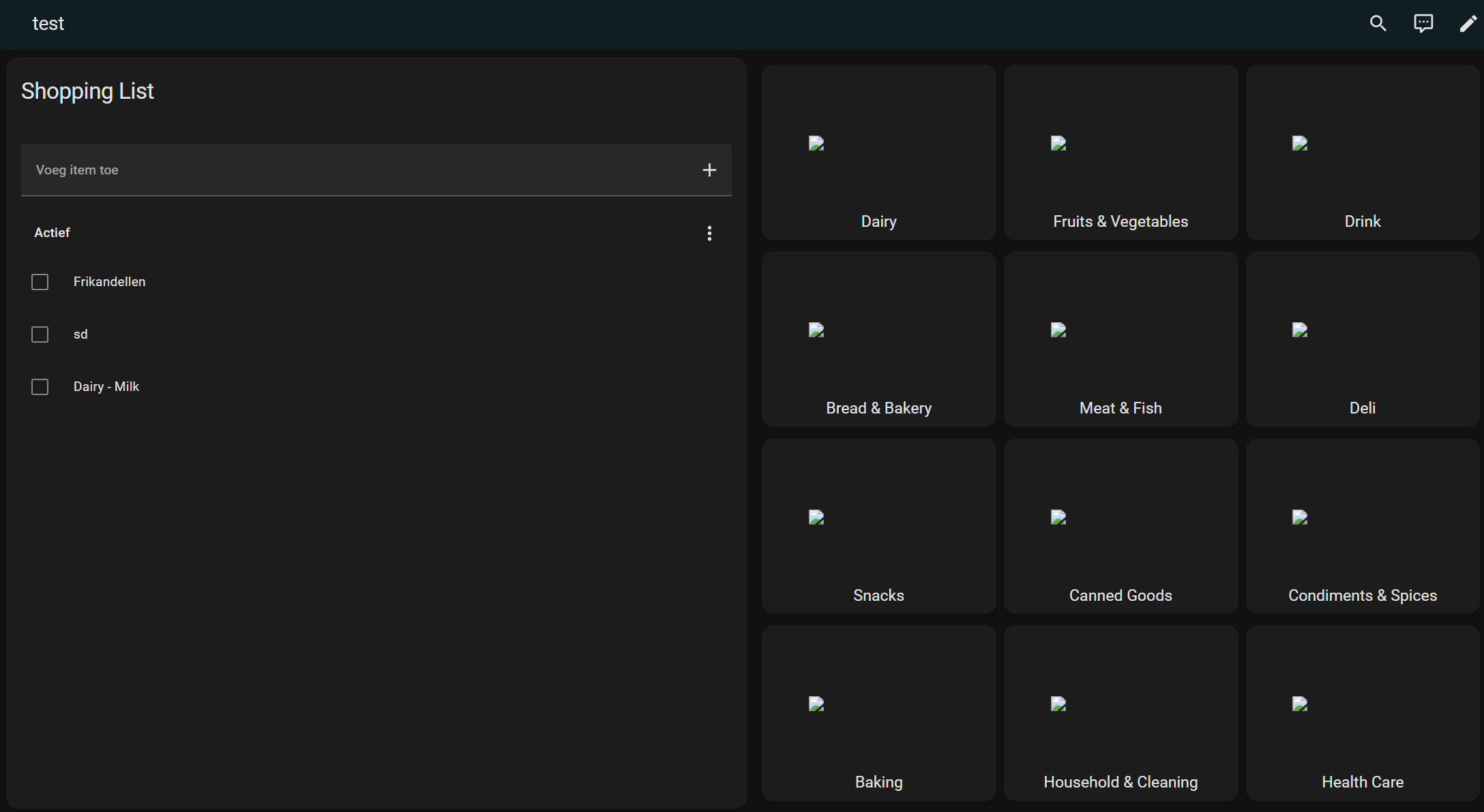

edit: @manunited10 Thanks alot !
@mquhob i did see you strugle with this code, it is easy :slight_smile: always watch and look that you have the code on the right place :slight_smile: I cant add more than 1 screenshot as a new user so if you want screenshots message me.
For other users, create a new dashboard, enter raw edit and let only views: in it
above views paste button_card_templates + shopping_list_category_card code
below views add the dashboard code.

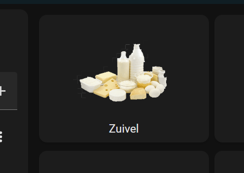

the ?v5 extension only works when i image is correct/transparant, still dont know what it does lol
What does ?v5 do after .png ?
with the ?v5 extension after png the image doesnt load but if i remove it then it works.
Ps for others: Double check that a image is transparancy, just pick on from the internet isnt 100% succesfull i found out lol.
