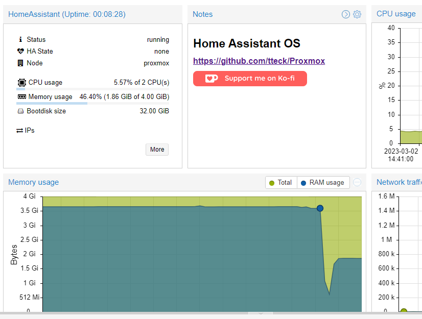

Being new to Proxmox, Iโ€™ve attempted to read up about the general usage of it, but Iโ€™m still a bit confused as the the difference between the amount of RAM that HA shows that it is using, out of itโ€™s allocated amount when creating the VM, and what Proxmox shows that the HA VM is using? For example, inside HA, I am seeing what I would expect having migrated from my old Intel NUC - I allocated 4GB RAM to the HA VM, as thatโ€™s what I had in my old NUC, and my new host machine has 8GB RAM total.
Generally HA sits at around 1GB of RAM while running, which is what I used to see.
In Proxmox, it seems 3.65GB out of the allocated 4GB is being used by the HA VM
Now this is a gradual increase. If i restart the HA VM, it makes no difference, however if I reboot my Proxmox node, then the RAM being used by my HA VM shows in Proxmox as around half that previously being used, around 1.86GB
it stays at this level for some time but gradually creeps up and plateaus at around 3.65GB after a few days.

Thanks for the info, thatโ€™s helpful. Iโ€™ve only setup Proxmox using defaults and following the info here, so should be similar to what you have setup as your VM. I didnโ€™t select ZFS, I chose LVM (which I take it is how you are using EXT4 file system?), so I donโ€™t believe ZFS is the cause of the memory usage increase that I am seeing. This is my setup:
and after 24 hours since my last screenshot when I restarted my host, I am back up to 3.19GB RAM usage showing in Proxmox for my HA VM, but still inside HA I am seeing around 1GB in use, like I would expect

Everything looks correct, I donโ€™t understand why the RAM usage shows so high. Hereโ€™s my RAM with and without HAOS running.
1.2 GB RAM difference.
It appears that I may have been mistaken and responded to the wrong person. My apologies for any confusion. To clarify, @Scoff, based on the information you provided, it seems that you have a total of 3922 MiB of memory, with 950 MiB currently in use, 2357 MiB for cache, and 2956 MiB available.
Edit:
If you have free RAM, itโ€™s possible that Linux will use it for caching. This can cause it to appear as though Linux is using a lot of RAM, even if your system isnโ€™t running many applications. However, this is normal behavior, and the RAM used for caching will be freed up as needed by running applications.
OK thanks @tteck , so itโ€™s the amount of RAM being cached which makes it โ€˜appearโ€™ that my HA VM is using more RAM than it actually is. Being new to Proxmox, itโ€™s just a bit concerning seeing the red Memory usage bar in the summary thatโ€™s all. I expect if you leave your HA VM running for a couple of days, you will end up with a similar amount of RAM being cached as I have. At least I know itโ€™s all behaving normally now :slight_smile:
