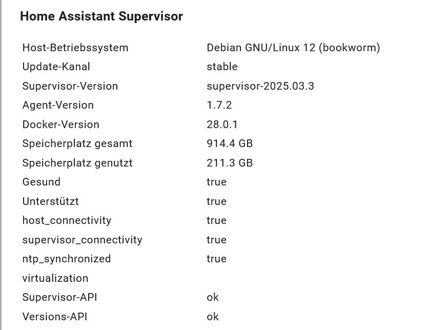

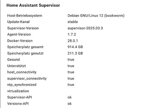

All done. Your HA Supervised should now run on Debian 12 (bookworm) and shows similar to:
:exclamation: In case you are still seeing the status "Unsupported" and/or "Unhealthy" at this point, re-run the "supervised-installer":
