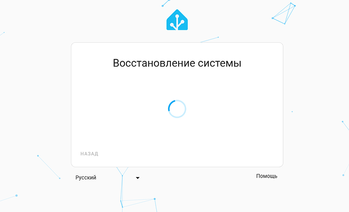

Hello !
Clean install Debian 12 (last release) and folowing instruction I get the following errors:
  1. dns stops working after completion of execution “apt install apparmor jq wget curl udisks2 libglib2.0-bin network-manager dbus lsb-release systemd-journal-remote systemd-resolved -y”
  2. errors when executing the installation script HA
  3. after correcting errors with hands, I try to restore a backup copy and it turns for hours (while the machine does not use computing resources)
For a possible solution to the dns-issue you might want to look HERE.
You should have given more attention to “Section 1 – Install Debian 12”, step 1.10, step 1.16, and step 1.17.
With this you would have continued “Section 2 - Install OS Agent, Docker and Dependencies” as that non-privileged user you have created with step 1.10 which in turn would most probably have saved you from these kind of privilege issues like “couldn’t be accesses by user '_apt”’ and “(13: Permission denied)”.
