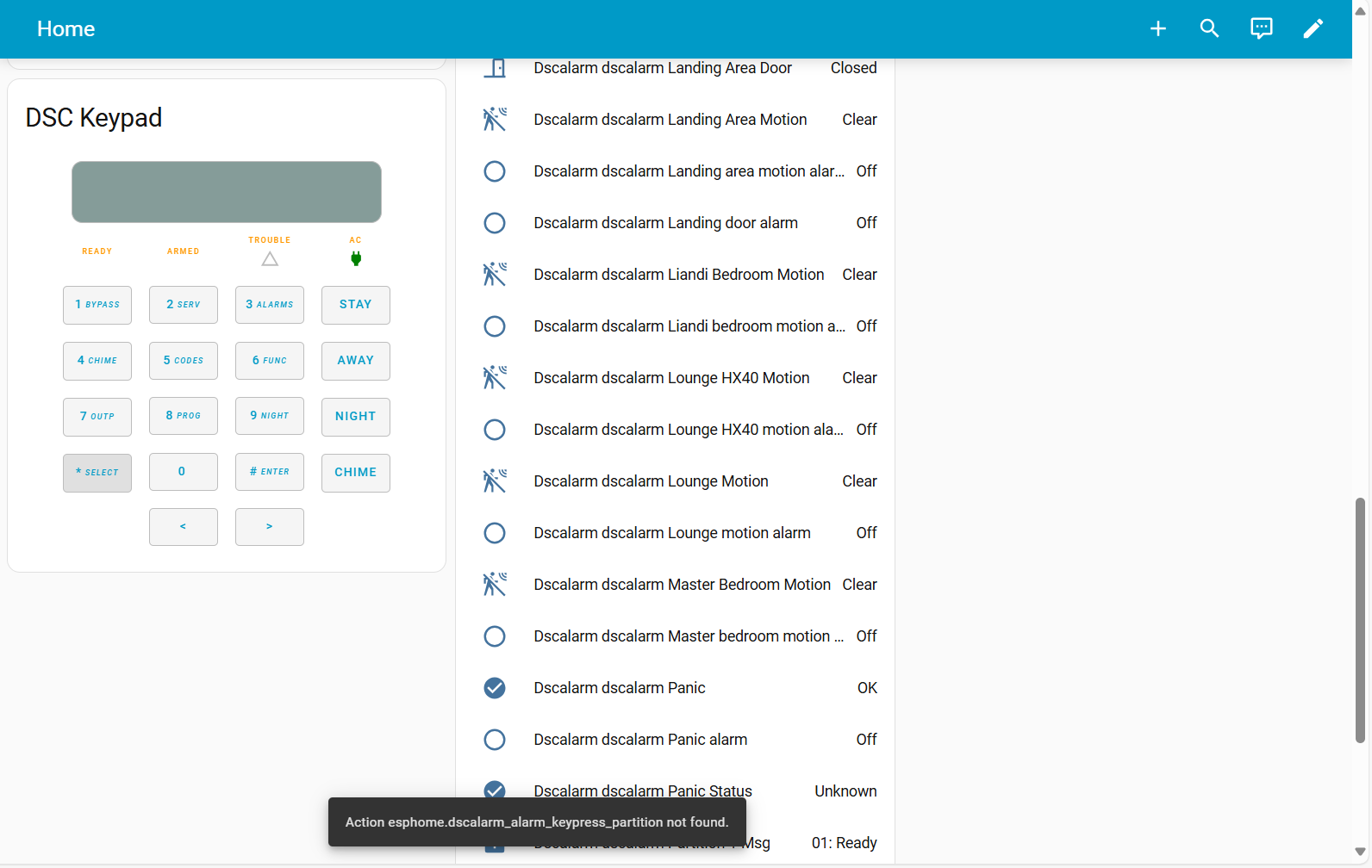

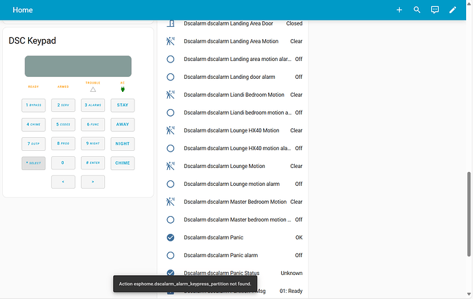

@Dilbert66 Thank you very much for sharing your work. I have been running my esp8266 on the DSC Alarm Home Assistant integration for a couple of years now with no issue and set up the simple alarm keypad (no full keypad was available with the integration back then). I recently decided to only upgrade the simple alarm keypad to the full keypad dou developed, but I am experiencing issues with getting it to work. I followed your guide and pasted the files in the www folder, which is in the same directory as the HA configuration.yaml (the www folder already existed). I also included the /local/alarm-keypad-card.js?id=2 entry in the resources, but find that when I create a new custom keypad in my Lovelace dashboard, there is no link to the integration and an error stating “Action esphome.dscalarm_alarm_keypress_partition not found” is displayed.
Could you kindly please assist me to resolve this problem and to get the full, custom keypad to work?
Home assistant has been messing around with entity and service naming structures now and ignoring sent id’s. You will need to find out from home assistant what your esphome device shows up as in ha. It will be based on whatever friendly name you set in your yaml. It used to be “dscalarm” by default but with the friendly name used now, it might be using “dsc_alarm”, etc

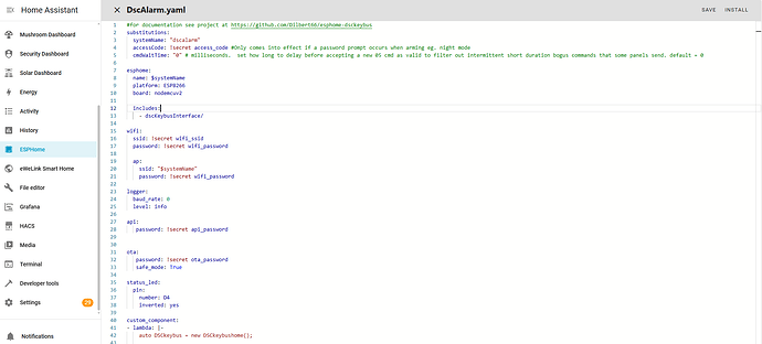

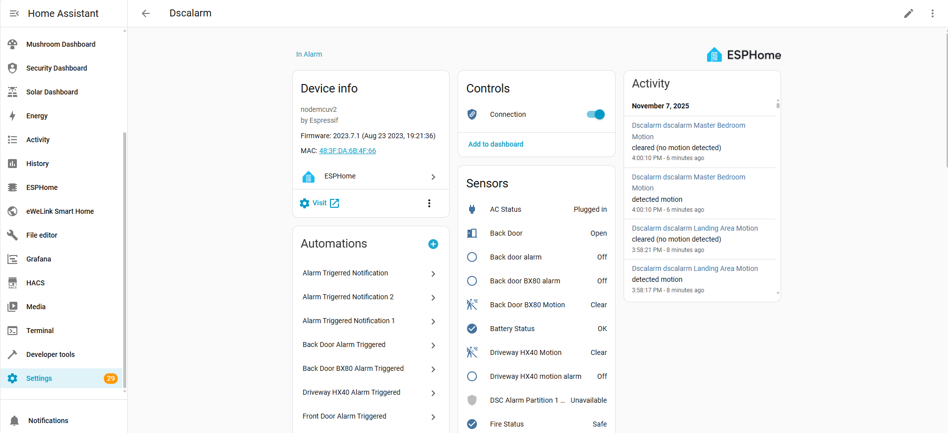

Dear @Dilbert66, thank you for your reply. Could you kindly please assist with pointing me in the right direction regarding obtaining the right naming structure and fixing the issue?
The device is displayed as “Dscalarm” in ESPHome under configured devices.
I am also not seeing a friendly name for the DSC Alarm

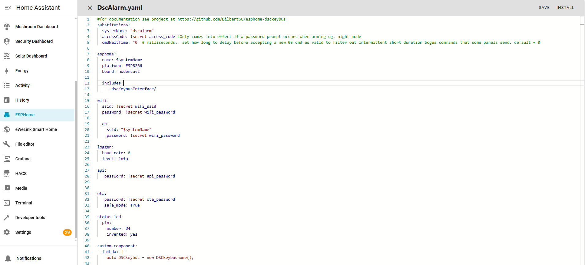

Dear @Dilbert66,
The device is displayed as “Dscalarm” in ESPHome under configured devices:
