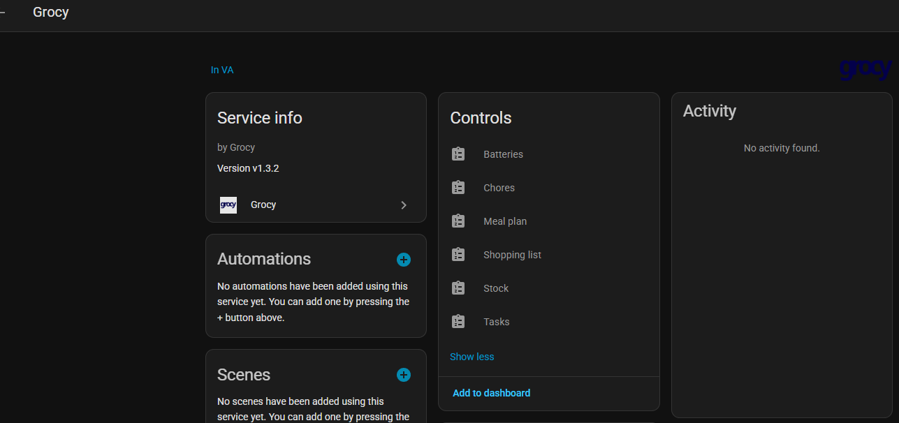

What is the specific issue?
If you are using the Add-on, the integration should be able to reach it through your HA instance's address on port 9192. You can change the port used in the Configuration tab of the Add-on if that port is being used by something else (make sure to save and restart the add-on if you make changes).
Regarding the integration, the original one seems to have been at least partly abandoned so use the one by iamkarlson, it is available in HACS.
I don’t know if it was the integration…but reinstalling the Addon and the integration I got it functioning!
Thanks for youtr help!
