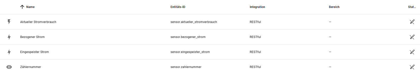

As far as I understand it now, I have to integrate the whole thing into HA via Curl.
Accordingly, it should look like this in configuration.yaml:
#BSED NanoBeemesPro v2.1 SmartMeter
rest:
- resource: http://192.XXX.XXX.XXX/data/
method: GET
headers:
Content-Type: application/json
scan_interval: 2
sensor:
#Aktueller Stromverbrauch
- name: smartmeter_current_consumption
value_template: '{{ value_json["1-0:16.7.0*255"] }}'
unit_of_measurement: kW
device_class: power
However, I get no value displayed. I assume very strongly that I’m on the right path, but I probably didn’t “think” it through to the end.
Maybe someone can help
Home Assistant runs on my Synology RS1221+ as a Docker instance. However, this is only as marginal information.
I hope I summarized everything that is needed. Please forgive me, I’m just getting used to HomeAssistant and I’m trying to solve a lot on my own, but I don’t seem to be making any progress here.
