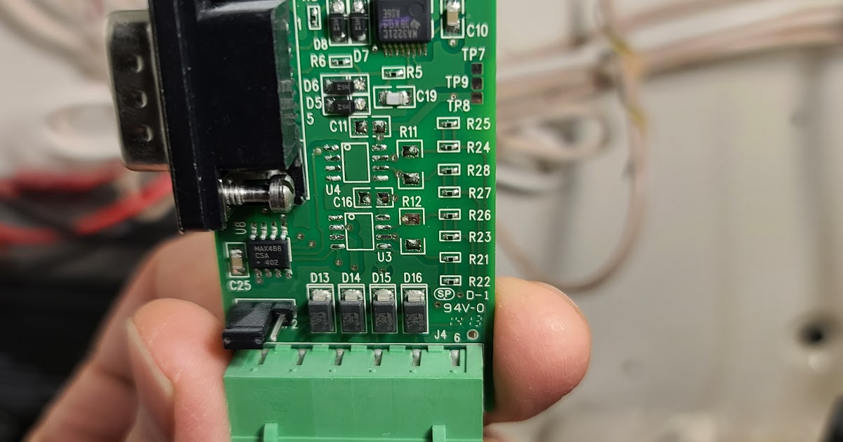

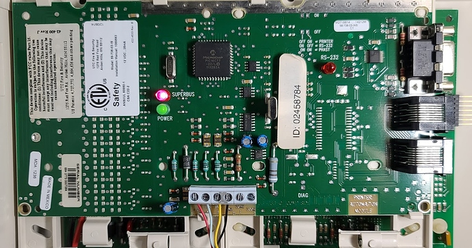

Hello @jesuscmartinez, did you ever figure this out? I experienced the same exact decoding behavior that you did, I am using an ADT Pulse system installed around 2015. The system works perfectly for all my wired/wireless sensors but I would like to control it (or at least monitor it) without relying on the ADT Pulse cloud service.
When I modified the concord232 code from the repo @JasonCarter80 (instead of using utf-8 I tried iso-8559-1 decoding) I managed to see that the bytes being sent from the AM were repeating in groups of F3, E3, and 80, FF. Which is not single byte and not what the specification states. So I believe either there is an encoding/decoding issue or ADT Pulse is using a different protocol than what is being used by most of the Concord open source. If anyone can point me in the right direction would greatly appreciate it!
Can you check the model number of your AM. If you do a little search you’ll find a number of discussions on this subject.
Thanks for responding @ConcordGE, I could not find anything specifically on my model. Here is a detailed description of what I am currently running for my pulse system.
Versions:
Interlogix Automation Module: 56-738-03-INS
ADT Main Panel (not sure of manufacturer): 56-851-95R
Netgear/ADT Pulse Gateway: PGZNG1
DB9->4 Wire (RS422 Converter?): No Model Number
The ADT Main Panel is connected to the AM using the 4 wires. The AM is connected to the Pulse Gateway using a little board that has no model but says “AM to iHUB V4” and “Square S”. This little board I am assuming it’s an RS422 converter of some sort and the 4 wires that come out (seemingly 2 pairs of RX/TX) go into the ADT Pulse Gateway.
So far I’ve tried using a standard RS232 DB9 to USB cable plugged into the AM module’s DB9 port - and all various forms of serial connection parameters and bauds, sometimes I get some control characters that are recognizable but then the rest of the message is garbled. I have yet to use a RS422 cable (I have one on order) to see if that makes any difference.
DB9-4-wire:
FYI I have detailed pictures of each module but the site won’t let me post more than 2 links or 1 photo at this point.
A couple of points to note:-
The AM model number you’ll need to this working is 60-783-02
Ensure your port settings are correct
The FTDI chipset serial to USB cable is known to work best.
Effectively you’ll need to change out your current AM for the model I’ve mentioned above. I’ve never heard anyone getting that ADT AM working with any plugins in the various different home automation software. It’s proprietary to ADT. Once you have the correct AM you can progress from there.
As I suggested have a good search around as there’s plenty of information out there on this subject. Try this forum and the Vera forum for further details on this subject.
I meant to include this link too. It gives a bit of background to the whole ADT saga. Hope it explains a few things along the way and saves you wasting time. http://forum.micasaverde.com/index.php?topic=49393.0
Thank you for this link.
From reading many of the forum posts around the ADT Pulse issues, it seems that most of the people running ADT Pulse had AM boards that ended in “-03”, and when they switched to boards that ended in “-02”, it just magically “worked” using the published protocol (with software like Concord232, etc.)
I managed to find the 60-783-02 board online, and will wait to see what really is delivered and if it works. In the meantime I’m going to keep plugging away at trying to decode the messages from the “-03” board, as that would be the idea solution IMO. If anyone knows someone that worked on these products at one point and would like to collaborate, please let me know.
