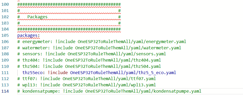

To the config I did a few customizations, like WIFI Network and credentials, also I commented all other devices out, beside my THZ 5.5 Eco.

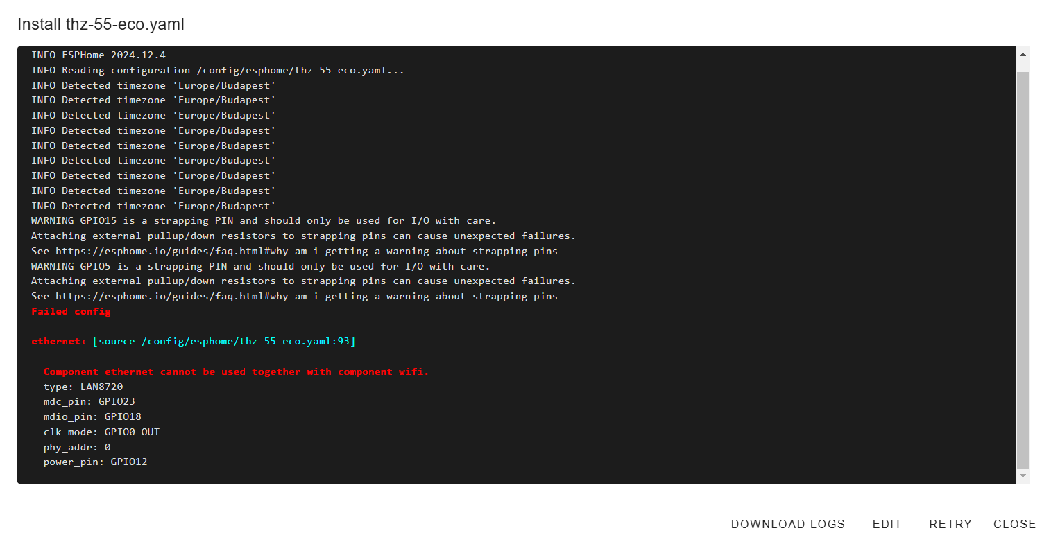

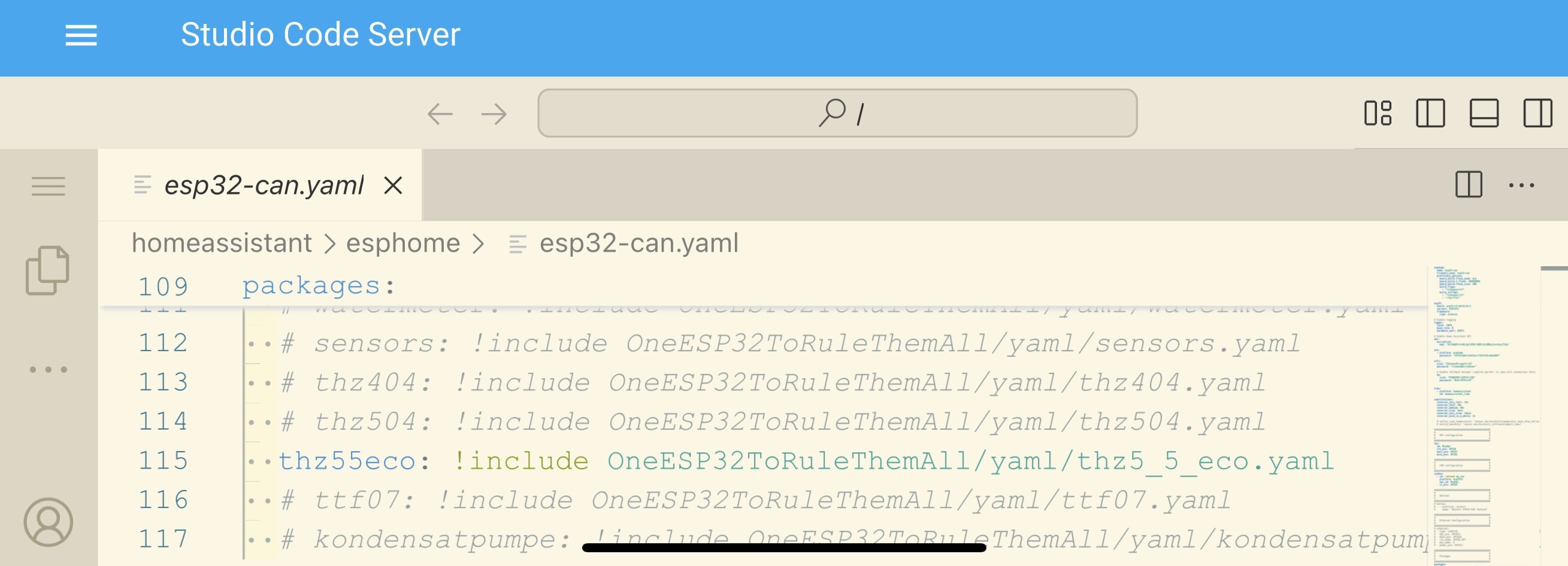

again @eugenpirogoff and @Exezz78, as a new forum member I’m not allowed to put two pictures in one post, so heres the next one:

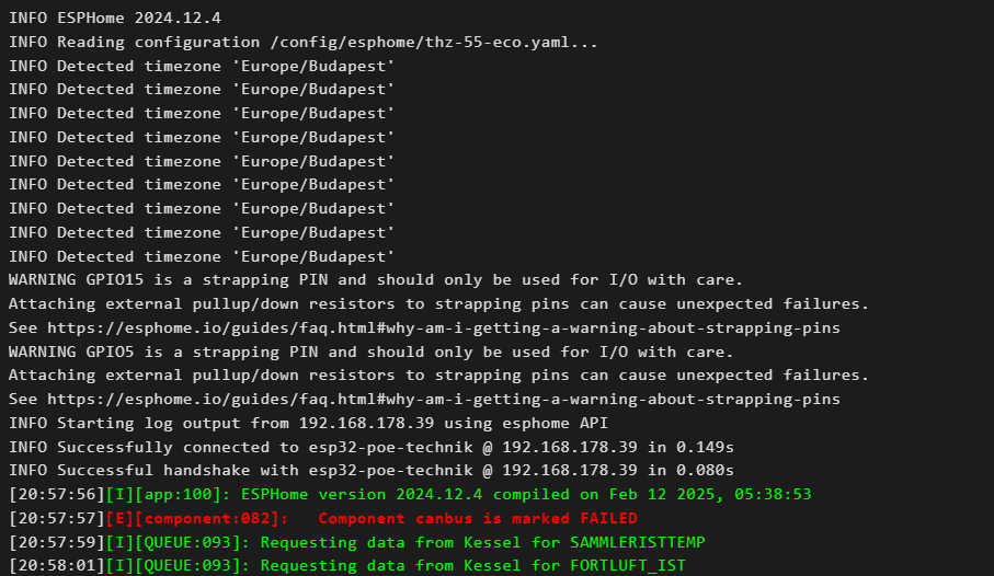

When I try to upload the cusomized YAML code with Wifi or cable connection I recieve an error as shown below:
So far for now, hope to have time this week to find the issue on this, maybe with your experienced advices :blush:
I guess Ethernet is not needed. Change it into a comment or delete the line.

@Exezz78, thanks for the ethernet hint, just oversaw that one code snipped which was nearly impossible to overssee with the commented section above :smile: :rofl:

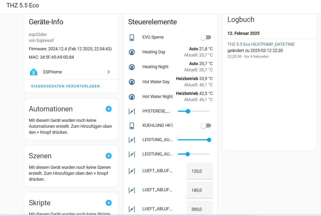

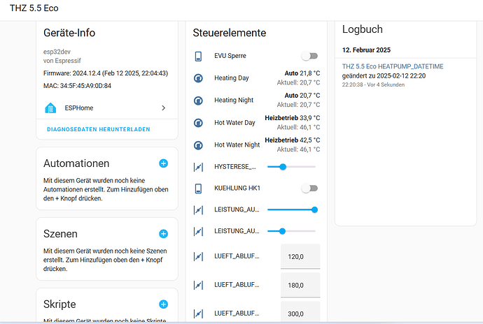

Flashing the ESP32 was now successfull, no errors so far and over 106 new elements in my HA - looks great.

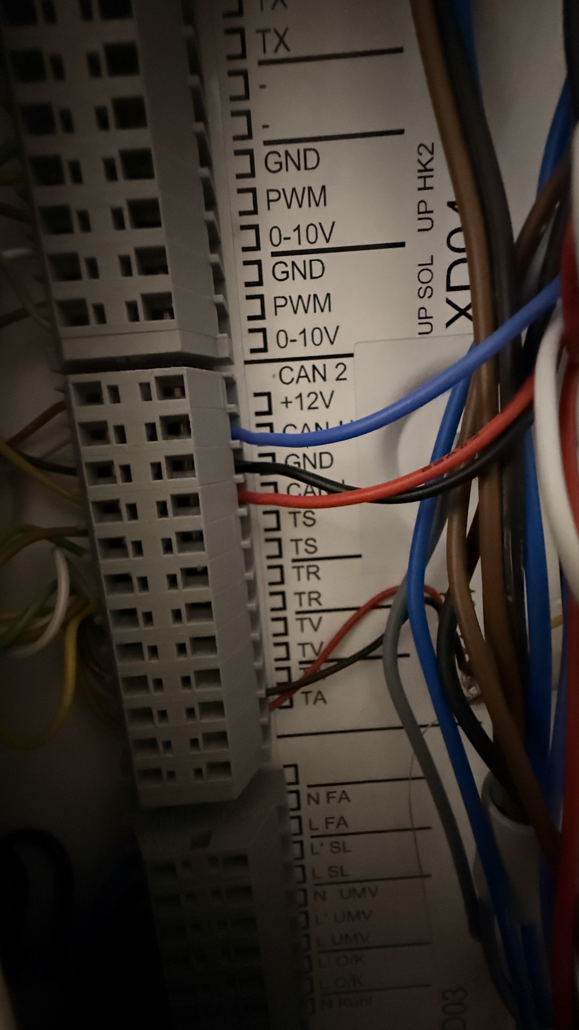

GND is actually not needed.
Thanks @eugenpirogoff, a few minutes ago I wired everything. Didn’t used ground for now, but want to run the power over the THZ with a 12v step-down.
I’m not sure if everything is connected correctly at my board, because I dont get all values at HA, I’ll wait now for 10 min and get back to this. The log looks like this:

Learnings for today, those boards are all different :sweat_smile:
Beside another wiring its also necessarry to change the GPIO values in the YAML file.
All values came up instantly into HA, looks really great!

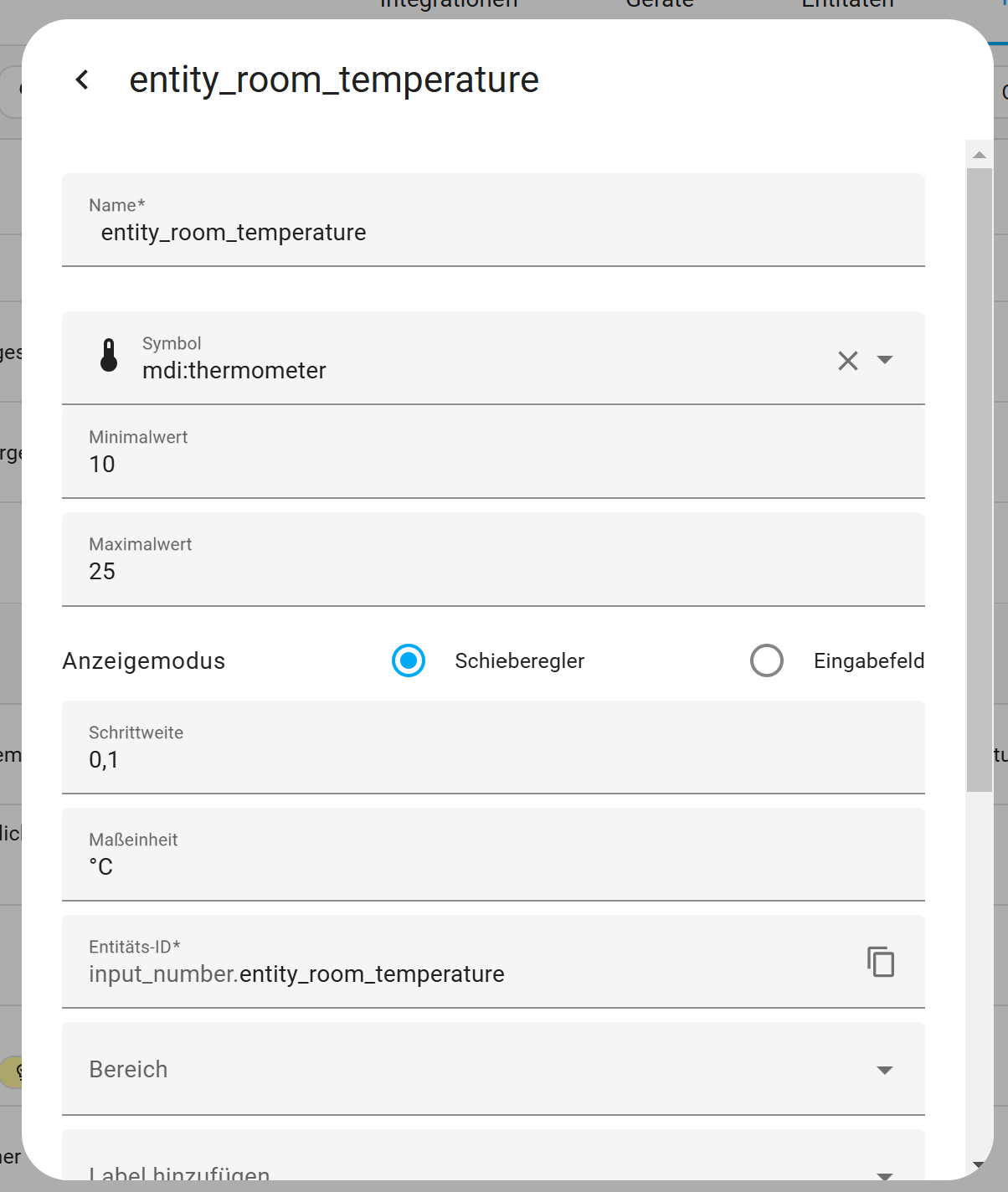

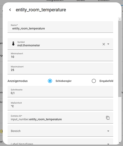

I’ve created a small Home Assistent helper in the helper section to set values
YAML:

Added the ā€œinput_number.entity_room_temperatureā€ to the common.yaml.

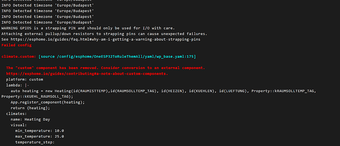

After that I’ve did logging in the ESPHome and recieve this error in the wp_base.yaml line 175.
So I guess something is wrong with my helper value.
You need to create the helper in Home Assistant, not in ESPHome :wink:
And for the error you need to pull again. ESPHome removed custom components
I’ve merged the fix some minutes ago
Maybe I wrote a bit unclear, the helper is Home Assistant entity, created in the helper section. Sorry for that, edited the content above.
Updated my comment again :wink:
