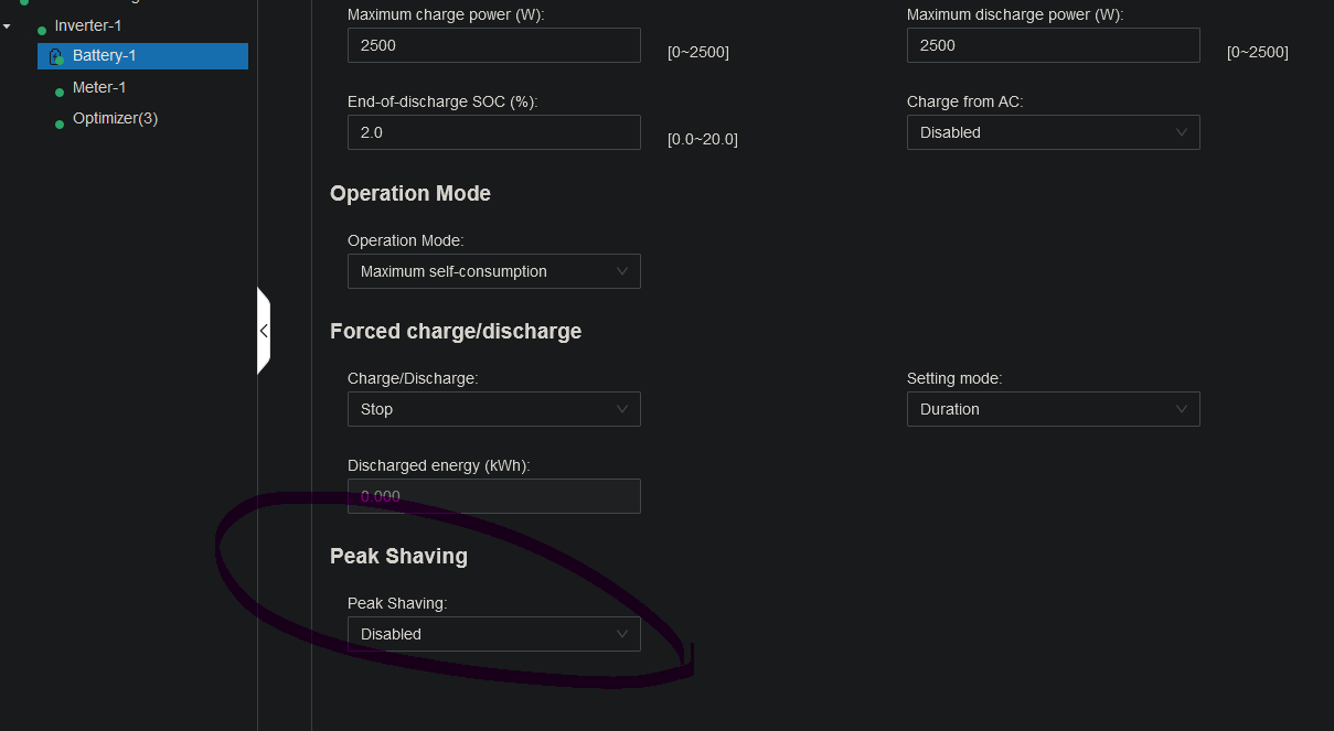

I have a huge problem with my inverter. This morning, I changed the ā€œPeak Shaving SOCā€ in the HA intergration and now my inverter has gone crazy. Even though the sun is shining, it does not produce any power anymore. From the data it appears as if it is now only producing power to charge the battery. Since the battery is full now, it has stopped producing power. How in the world can I turn off all the peak shaving stuff? I can’t find a setting in Fusionsolar nor the HA integration to turn it off. Thank you!
With the use of the FusionSolar App and your installer account you can correct as proposed by Huawei.
Not the answer you are expecting for sure …
My settings:
I have played with:
Thank you. I always use the Sun2000 app with my installer account to change settings, but I could not find anything in there regarding ā€œpeak shavingā€. Not sure if my inverter even supports it.
After doing some more error diagnosis, I found that the inverter does not seem to produce AC power anymore. It charges the battery using DC power but cannot supply AC power anymore. Now I have to find out if this is a hardware problem or some other problem.
PS: So my problem does not seem to be related to changing the setting. Just a conincidence.
Peak Shaving is under my battery setting:
