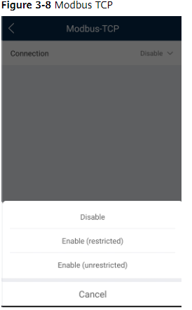

as it is described in the docs, there should be a new parameter to enable TCP-Modbus2021-11-15 15_56_50-SDongleA-05 MODBUS TCP Guide.pdf - 1 -
2021-11-15 15_56_50-SDongleA-05 MODBUS TCP Guide.pdf - 2 -
2021-11-15 15_56_50-SDongleA-05 MODBUS TCP Guide.pdf - 3 -
but I was not able to find it in my config after dongle update to 124 and inverter to: V100R001C00SPC139
So I’m back on 123 in my dongle.

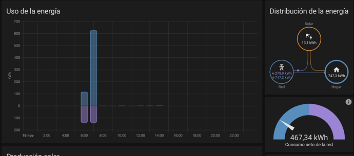

WT*?!??!
747kWh home consumption in 2 hours!!! XDDD
Grid export & home consumption are both stratosferic levels :-Āæ??Āæ?
Someone else?
Thank you.
Did you checked when it happened? The usage is count by template. If it happened after HA restart it’s mean that probably template was count before the value was read from inverter. In my case it helped adding checking if value from which it’s count is greater then 0. I’m using newest version of integration.
