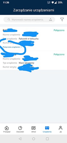

What do you see when you Open “dispositivo connesso” on first screenshot?
Image 2 (Inverter-1) and Image 3 (Inverter-1(1)) it’s what I see clicking on “Dispositivo Connesso” for the first Inverter. Image 4 and 5 for the second inverter.
Did you click in the blue text? For me I see connected devices to inverter, 2,3,4 and 5 screenshot I see when I touch over the blue text.
So if I correctly understand you have two inverters and in one of them is pluged in Smart dongle and both are connected together by modbus. From this integration do you see in HA data from both inverter or from first one? I think the Smart meter could be on slave: 2 or 3.
So, slave on “2” made the magic, apparently “1” refers to a single battery and “3” refers to the other 2.
