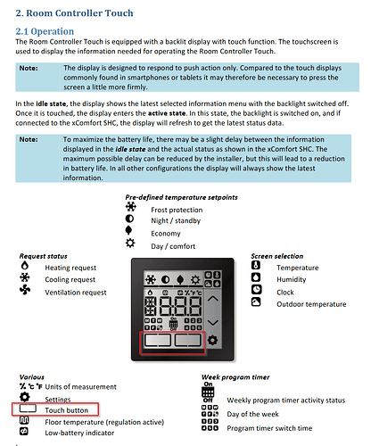

I played with the settings and saw the RCT supports two touch buttons that allow for example to switch a light on and off. Most likely this requires an Eaton device that is supported, but I was wondering if the integration can be used to just read out the 2 buttons, so it can be used to control other items in Homeassistant.
Currently i do not see any sensors that represent the touch buttons.

  • Where did you see that the RTC supports 2 touch buttons? Screenshot please.
The xComfort Bridge does provide events for button clicks. You can use those through the Alexa Integration and it is possible to loop that back to HA. The Google Integration does not support button events.

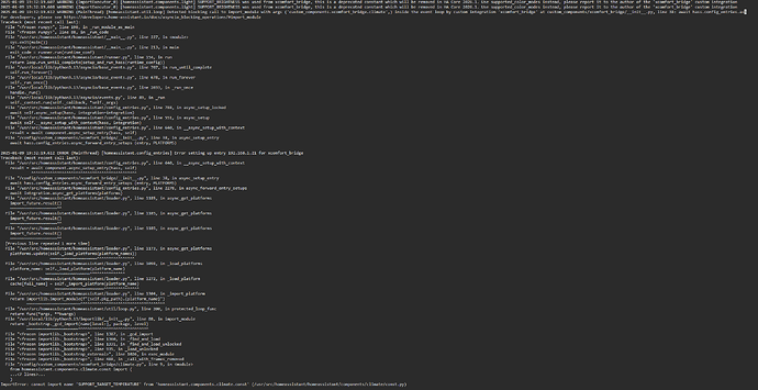

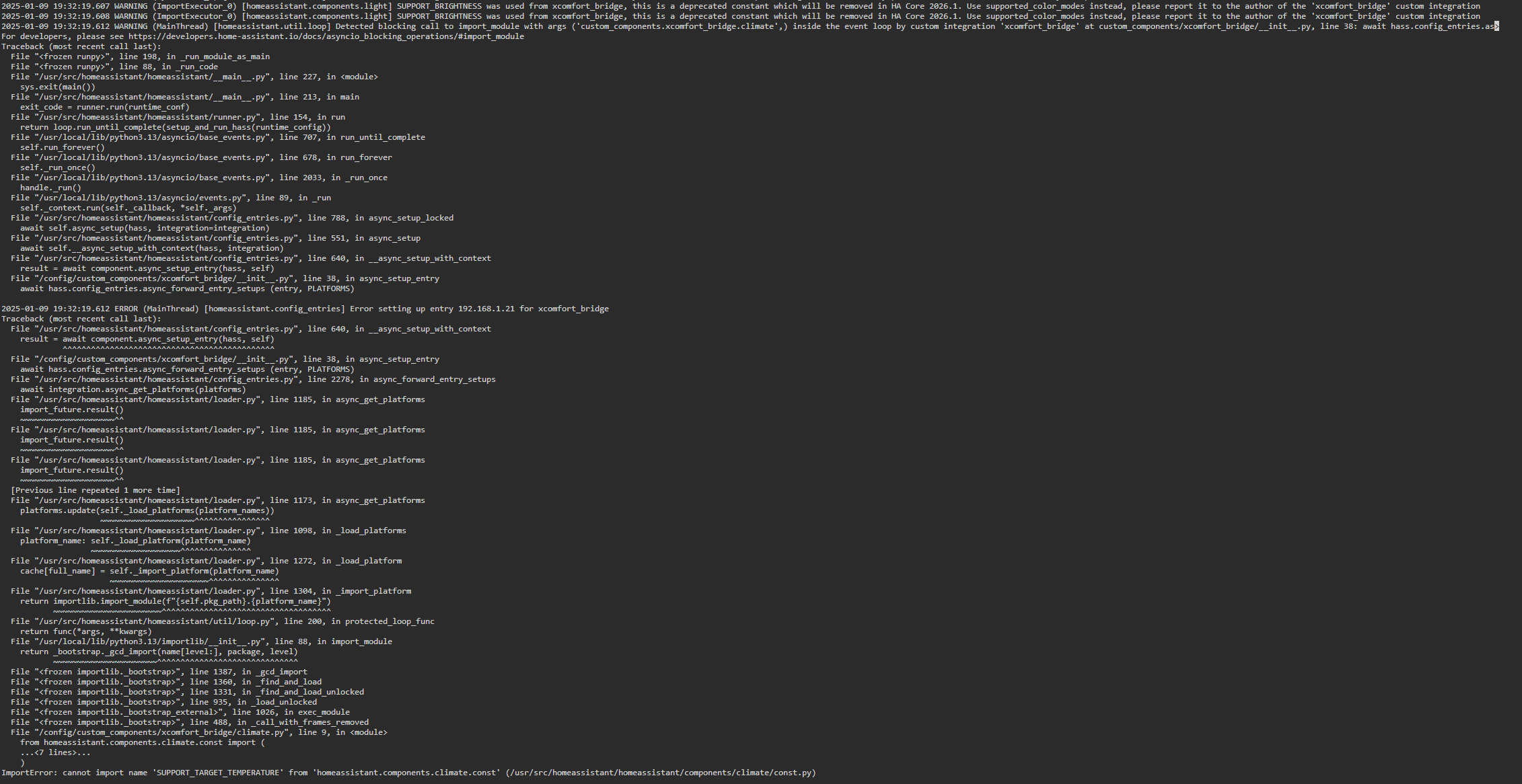

I’ve downloaded latest, added it ok, but am getting issues preventing xcomfort_bridge to load properly. Logs from HA added, seems to be something blocking in import_module and depricated functions in climate.py.
I should have at least the latest master-branch.
