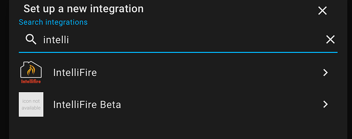

After I fixed these Changs … .I changed manifest to look like:
"domain": "intellifire_b",
"name": "IntelliFire Beta",
And that way it didn’t conflict with the existing intellifire integration… HOWEVER
When I tried to configure it:
And I can’t figure out what’s going on in the logs…
All it says is:
2022-02-10 09:49:28 WARNING (MainThread) [asyncio] Executing <Task finished name='Task-866' coro=<FlowManager._async_init() done, defined at /Users/jstein/devel/core/homeassistant/data_entry_flow.py:213> exception=UnknownHandler() created at /usr/local/Cellar/[email protected]/3.9.10/Frameworks/Python.framework/Versions/3.9/lib/python3.9/asyncio/tasks.py:361> took 0.150 seconds
