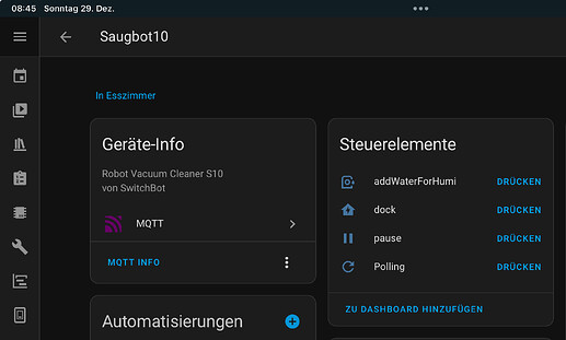

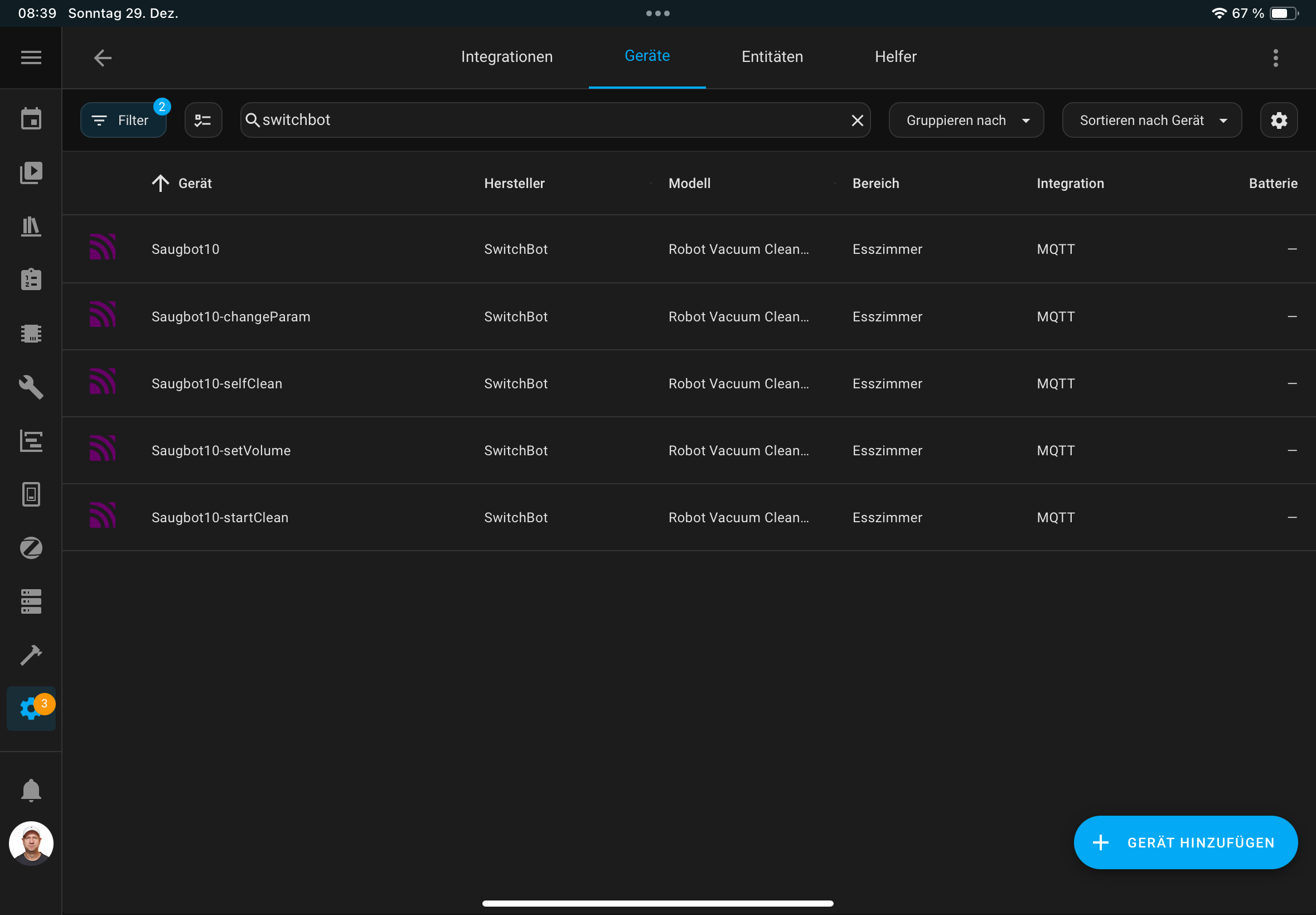

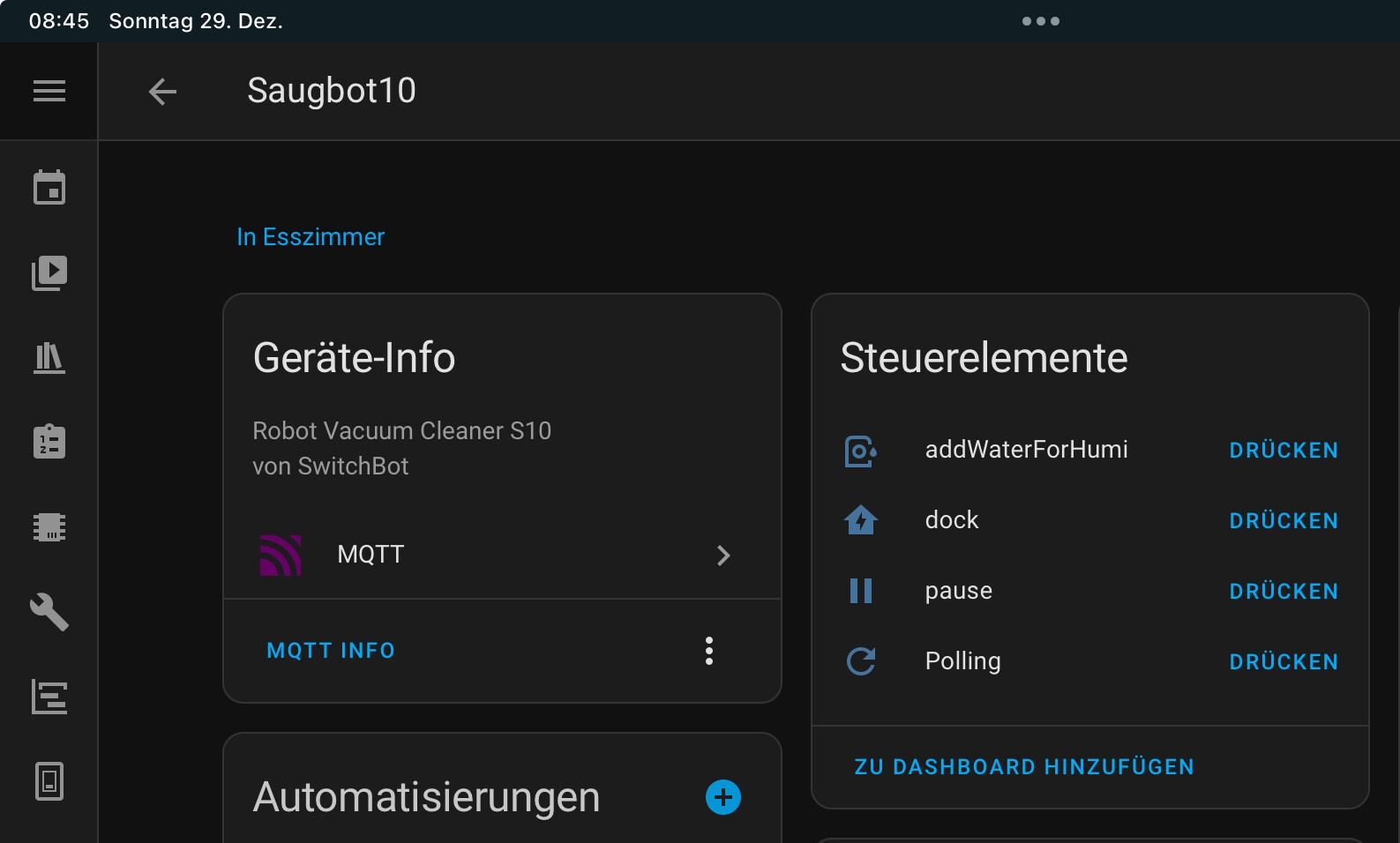

I have three question regarding Switchbot S10. The integration creates a lot of entities splitted in 5 MQTT devices
  1. Is it possible to consolidate all the entities in one device?
There is no standard control element which can used in a vacuum card. Instead the entities are exposed as single control elements.
  1. Is it possible to merge all relevant entities in one control in order to use the controls in a vacuum card?

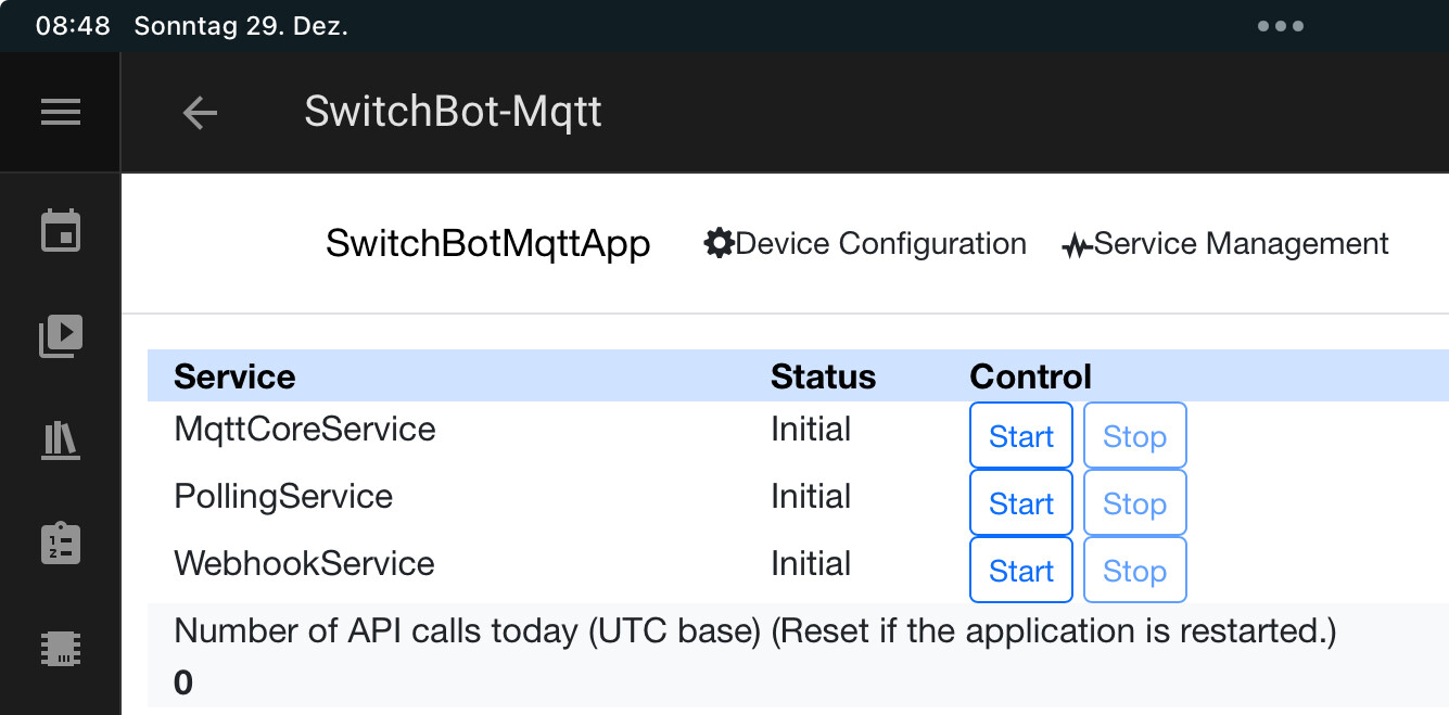

After Home Assistant Restart the services does not restart automatically. They remain in initial. In that status control the device is not possible.
  1. How can i automate to restart the services when after Home Assistant has restarted? (Watchdog is activated in the Add-On but does start the services autoamtically in my case)
@smartmatic
Q1,2
A. Please refer to the following discussion:
Q3.
A. There is an option called AutoStartServices in the add-on.
Please refer to the following Wiki:
