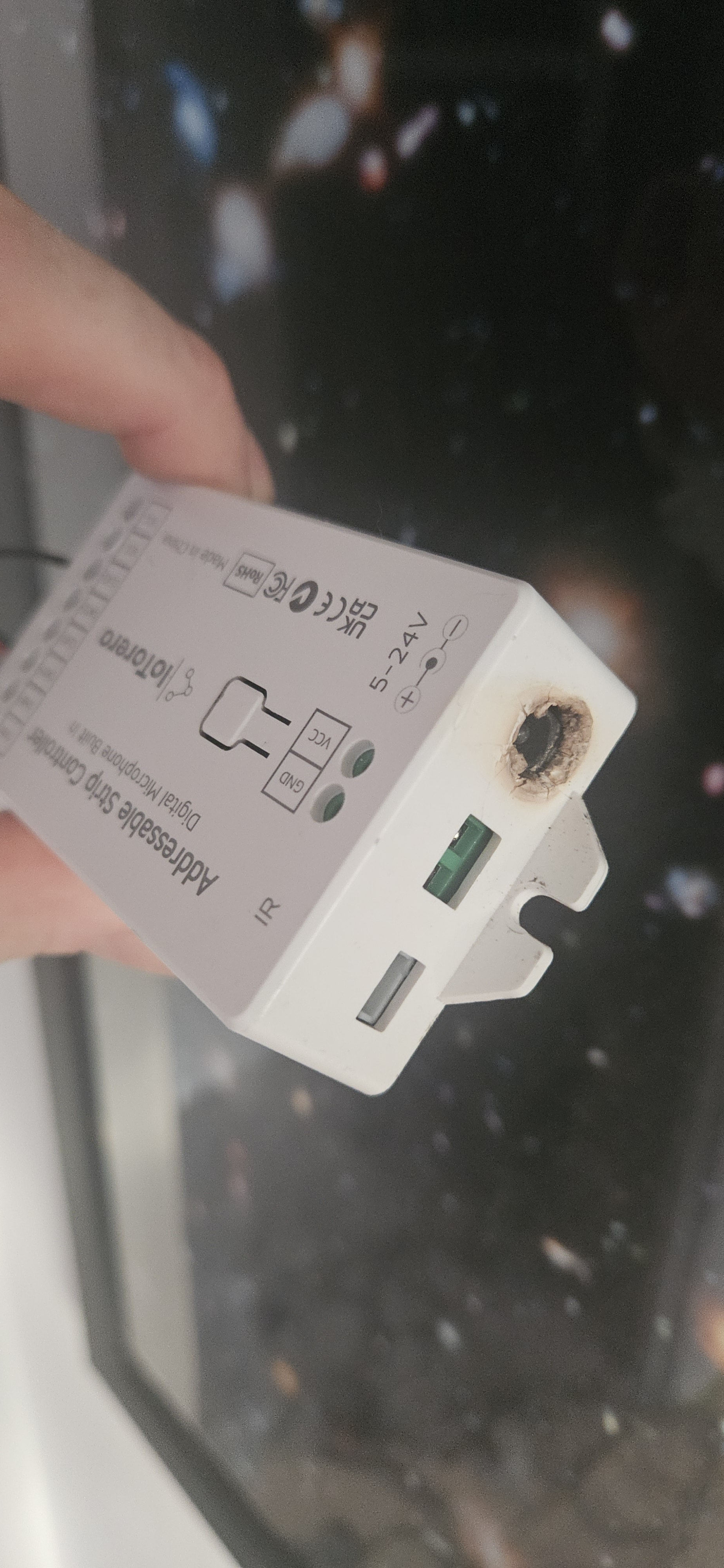

Please, for the love of God, don’t buy stuff from this company. It’s electrically unsound, this is the third W led controller. I have to fall that I bought from them that have pretty much fused a nearly set on fire. I mean take it as red anthom as they were known got banned from selling their goods in the whole of the e.U. electrically, unsound morally bankrupt and overcharging for the crap that they’re trying to sell
