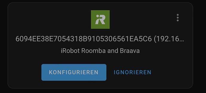

I see this:
And then I‘m ask to “manually connect to the device” and that no roomba or braava device was found. However, the shown IP address is correct.
After tapping on "Send“ and waiting for a while I see "Connection failed“ and that‘s it.
