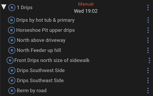

I’m using 2024.1.0 and testing out the sequence cancel feature and seeing odd behavior. Seens the UI gets in an odd state.
Starts as as expected – I have the times set low for testing.
Then if I do a manual run for 60 seconds sometimes it will show all the times for each valve/station.
Other times it just goes to this screen not showing any times. Note the 19:02 time is in the past, so not quite sure what that means (it’s 19:20 now).
I can make the times come back if I disable and then enable again. But also when I do that sometimes some stations towards the end turn on. Not sure if it’s where I last cancelled.
And now I cannot start a manual run.

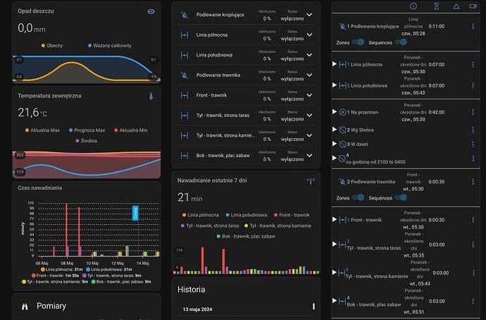

It seems it works fine, irrigation-unlimited-card is displayed correctly but I struggle with remaining webgui bits and pieces.
