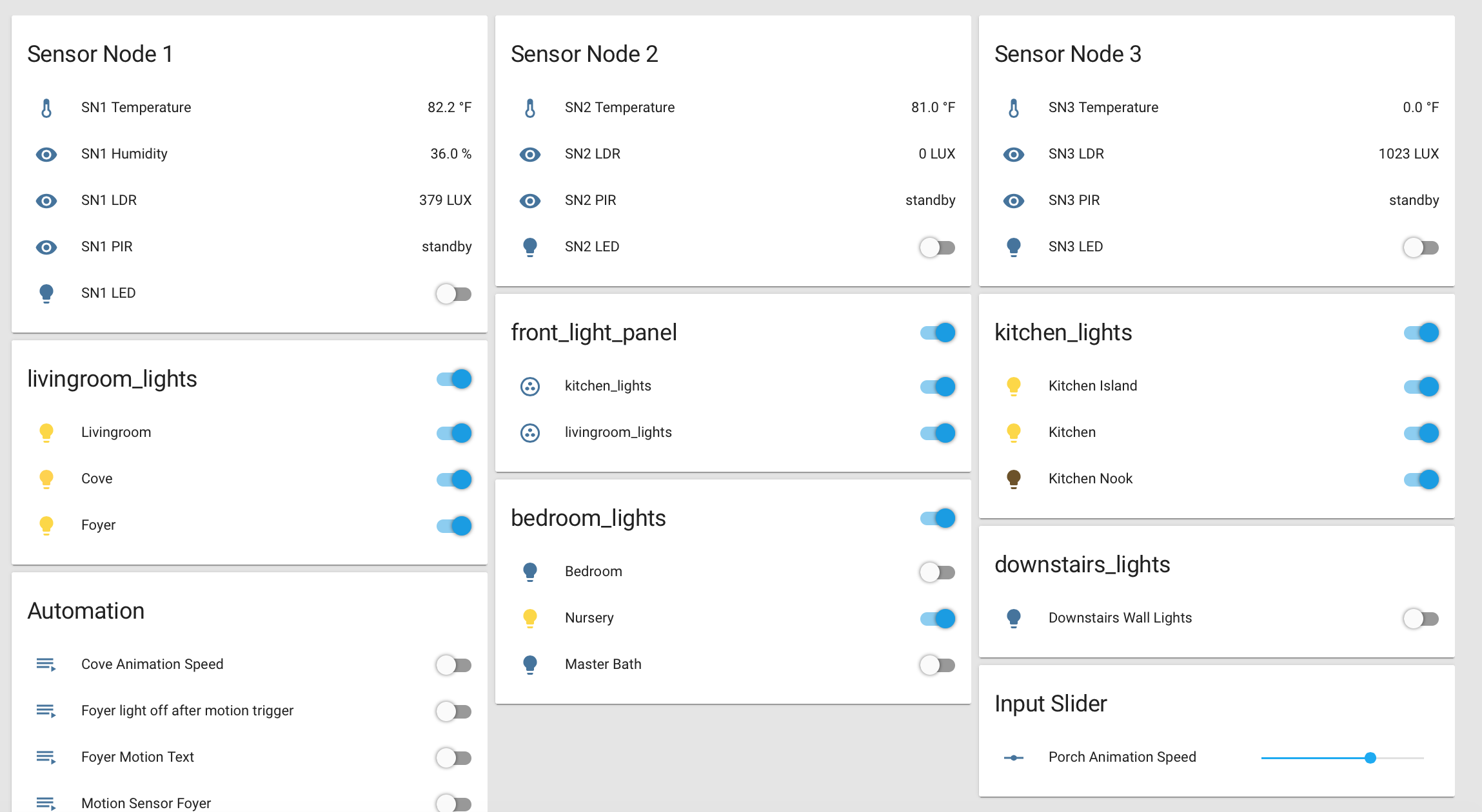

Not sure how to get HA to list all components, but, in a nutshell:
Lutron Caseta (about 8 dimmers), Phillips Hue (LED strip and a light), 3 or 4 DIY multisensors, Netatmo (which is currently not loading), and a DIY addressable LED strip.
heres a screenshot of front end (w/o the Netatmo):
Happy to post .yaml file too if nec
