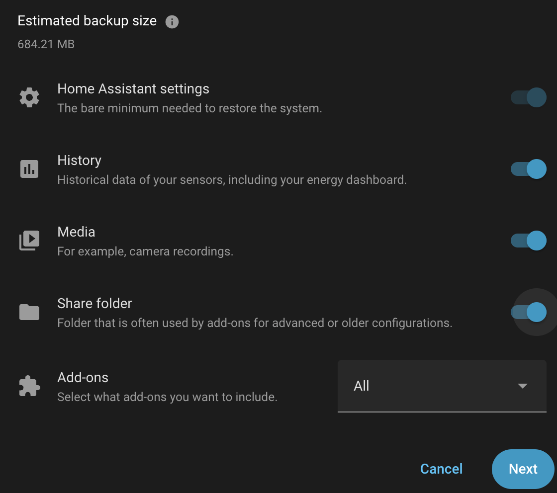

That is no longer in my automatic backups. I just created another backup turning everything on:
Which generated this:

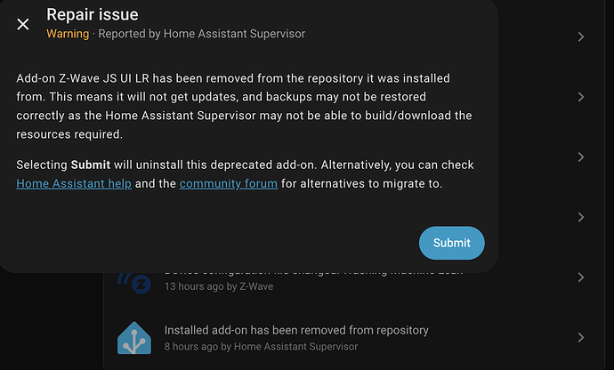

By the way, this is what clued me in on the issue. After restoring on a different machine I got this repair:
I don’t want to uninstall the add-on. The I manually restored the local add-on config to the /addons directory and restarted.
How do I remove the repair issue? Is there someplace they are stored I can modify?
