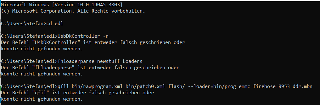

Many thanks again for every help provided - is there any help video available that describes how to run EDL? Really, I am working all the installation guides but it simply does not work. I have installed all the above but my command line accepts nothing like “UsbDxController” or “fhloaderparse” or “qfil”
I don’t use windows, so assistance from me will be limited. Just from looking at your screenshot:
  1. Ensure that usbdk is installed and present in your $PATH
  2. The edl binary must precede you arguments.
  3. If not executing edl from the root of extracted archive, then must modify paths to suit.
