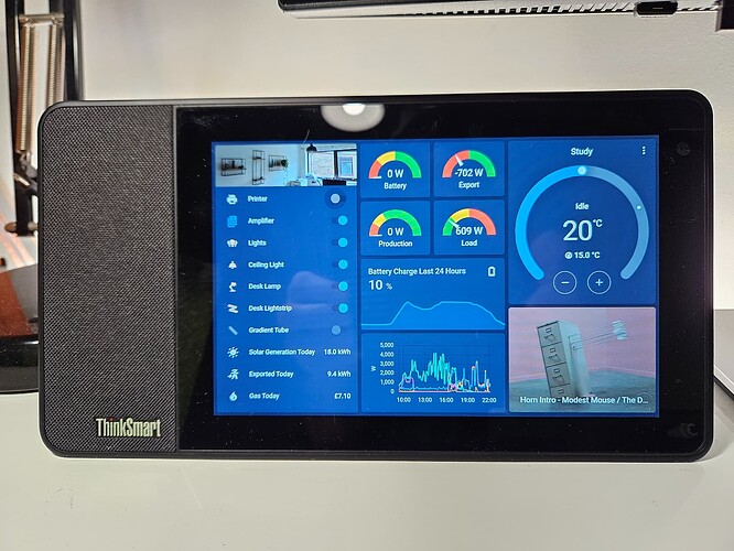

This is the latest dashboard I’ve been working on - similar on all devices but with different lighting scenes and individual lighting controls. Mix of mushroom and bubble card for the popups. Lots of things happening here including conditional alert cards for water softener salt level low, post through letterbox, popup front door camera with TTS announcements etc.Washer and dryer give estimated times and current modes (probably one of the most useful bit of info). Tried to keep it simple with only the most useful info shown.
…and what I’ve found REALLY useful is to setup a maintenance dashboard where I can manage all of my ThinkSmart devices and nspanel pro’s. I can dynamically set header and sidebar on/off, restart the browsers and reload the start URL. So when programming in my office, I just click and they all reload and refresh ready to go. Love these!
