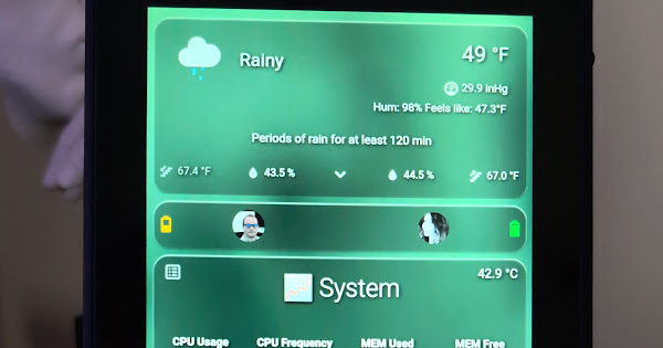

Noticing this thing feels a bit pokey in the H-A app. Any recommendations to improve the responsiveness?
I’m seeing the same thing in my dashboards. It’s pretty snappy in the rest of the app and plays my camera streams without noticeable latency, so it seems to be specific to Lovelace.
Edit: I noticed that the time and date were not updated by NTP, and so the date was a couple of weeks behind. After correcting the time and date, it’s more responsive. Still not great, but it doesn’t feel straight up broken the way it did before.
EDIT: Disabled some card-mod transitions I had across those views shaved about a second off of load times ¯_(ツ)_/¯
I created a new dashboard with only the items I deemed necessary and that seemed to help quite a bit as my normal dashboard is “heavy” lol
About a 1-3 second delay on initial view loads as seen in the my video:
