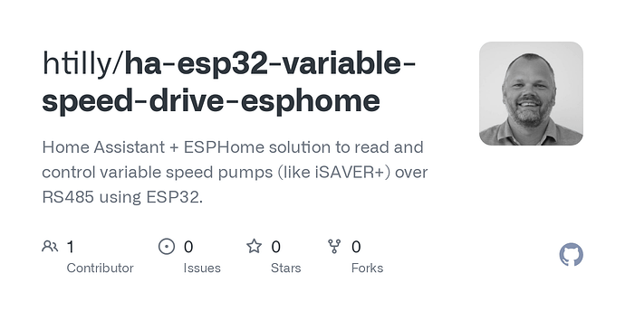

I put it on Github:
Enjoy :smiley:

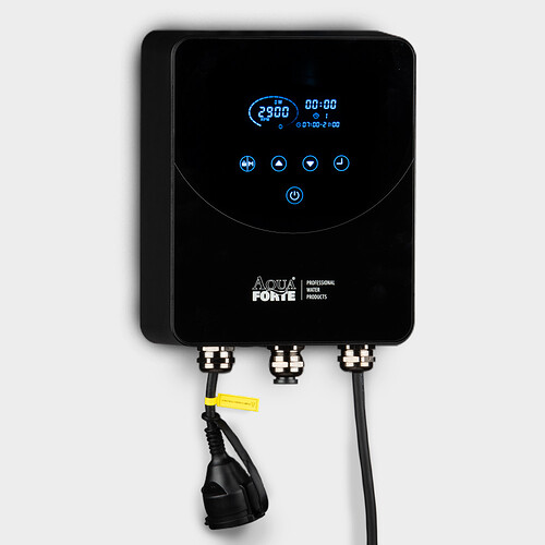

I want to be able to control this frequency inverter through HA, and also set some automations later on.
I want to connect the saver with a usb to rs485 connector. That worked. HA ‘sees’ it on usb0.
If I’m right , the code provided here is written for using an esp (so wirelessly?) instead of a usb-connection. Is there a way to get somewhere this code for a direct usb connection ?

if someone wan’t to retrofit the external control (modbus,digital,analog) for the newer iSaverX models, like:
you can find this and also a more advanced esphome (8266) configuration here:
bye

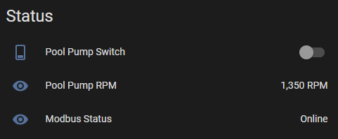

I have Rapid X20 inverter. I’ve implemented the interface as described, but it doesn’t work as expected. The state of Modbus is “Online”, but the value of RPM is most of the time “0”, sometimes it shows different values like 512, 4096, 16384, 32768. I’ll be grateful for some advise how to improve it.
Here is my config:

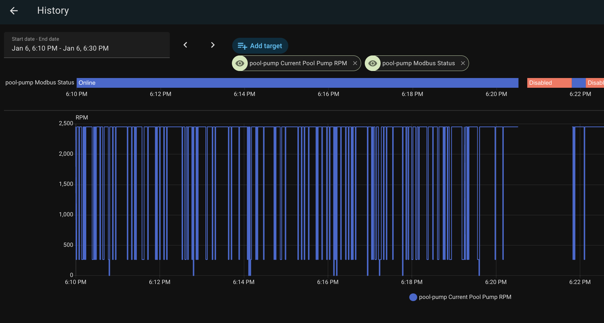

and logs:
[22:18:04][D][uart_debug:114]: <<< 00:00:00:00:00:00:40:00:00:00:00:40:00:00:00:00:40:00:00:02:00:00:00:00:02:00:00:00:00:02:00:00:00:00:02:00:00:00:00:00:00:00:00:00:00:00:00:00:00:00:00:00:00:00:02:00:00:00:00:00:00:00:00:00:00:00:00:00:00:00:00:00:00:00:00:10:00:00:00:00:00:10:00:00:00:00:00:00:02:00:00:00:00:00:02:00:00:00:00:00:00:00:00:00:00:00:00:00:00:00:00:00:00:00:00:40:00:00:00:00:00:00:00:00:00:00:00:00:00:00:00:00:00:02:00:00:00:00:00:00:00:00:00:00:00:00:10:00:00:00
[22:18:04][D][uart_debug:114]: <<< 00:00:00:00:00:00:00:00:00:00:00:00:00:00:10:00:00:00:00:10:00:00:00:00:00:00:00:00:00:00:00:00:00:00:00:00:00:00:00:00:00:00:00:00:00:00:00:00:00:00:00:00:00:00:00:00:00:00:00:00:00:00:00:00:00:00:00:00:00:00:00:00:00:00:40:00:00
[22:18:04][D][uart_debug:114]: >>> AA:C3:07:D1:00:00:0D:4D
[22:18:04][D][text_sensor:069]: 'Modbus Status': Sending state 'Online'
[22:18:06][D][uart_debug:114]: <<< 00:02:00:00:00:00:00:00:00:00:00:00:00:00:00:00:00:00:00:00:00:00:00:00:00:00:00:00:00:00:00:00:00:00:00:00:00:10:00:00:00:00:00:00:00:00:00:00:00:00:00:00:00:00:00:00:00:00:00:00:00:00:00:00:00:00:00:00:00:00:00:00:04:00:00:00:00:00:00:00:00:00:00:00:00:00:00:00:00:00:00:00:00:00:00:00:00:00:00:00:00:00:00:00:00:02:00:00:00:00:00:00:00:00:00:00:00:00:00:00:00:00:00:00:00:00:00:00:00:00:00:00:00:00:00:00:00:00:00:00:00:00:00:00:00:00:00:00:00:00
[22:18:06][D][uart_debug:114]: <<< 02:10:00:00:00:00:00:00:00:00:00:00:00:00:00:00:00:00:00:00:00:00:00:00:00:00:00:00:00:00:00:00:00:00:00:00:00:00:00:00:00:00:00:00:00:00:40:00:00:00:00:00:00:00:02:00:00:00:00:02:00:00:00:00:02:00:00:00:00:00:00:00:00:00:00:00:00:FF
[22:18:06][D][uart_debug:114]: >>> AA:C3:07:D1:00:00:0D:4D
[22:18:06][D][text_sensor:069]: 'Modbus Status': Sending state 'Online'
[22:18:06][D][sensor:104]: 'Current Pool Pump RPM': Sending state 512.00000 RPM with 0 decimals of accuracy
[22:18:06][D][number:012]: 'Pool Pump RPM': Sending state 512.000000
[22:18:06][D][uart_debug:114]: <<< 00:00:00:00:00:02:00
[22:18:08][D][uart_debug:114]: <<< 00:00:00:02:00:00:00:00:00:10:00:00:00:00:00:00:00:00:00:00:00:00:02:00:00:00:00:00:00:00:00:00:00:00:00:00:00:00:00:04:00:00:00:00:00:00:00:00:00:40:00:00:00:00:00:00:00:00:00:00:00:00:00:00:00:00:00:00:00:00:00:00:00:00:20:00:00:02:00:00:00:00:00:00:00:00:00:00:00:00:00:00:00:00:00:00:00:00:00:00:00:00:00:00:00:00:00:00:00:00:00:00:00:00:00:00:00:00:00:00:00:00:00:00:00:00:00:00:00:00:00:00:00:00:00:00:00:00:00:00:00:00:00:00:00:00:00:00:04:00
[22:18:08][D][uart_debug:114]: <<< 00:00:00:40:00:00:00:00:00:00:00:00:00:00:00:00:00:00:00:00:00:02:00:00:00:00:00:00:00:00:00:00:00:00:00:00:00:00:20:00:00:00:00:00:00:00:00:00:00:00:00:00:00:00:00:00:00:00:00:00:00:00:00:00:00:00:00:00:00:00:00:02:00:00:00:00:C0
[22:18:08][D][uart_debug:114]: >>> AA:C3:07:D1:00:00:0D:4D
[22:18:08][D][text_sensor:069]: 'Modbus Status': Sending state 'Online'
[22:18:08][D][sensor:104]: 'Current Pool Pump RPM': Sending state 0.00000 RPM with 0 decimals of accuracy
[22:18:08][D][number:012]: 'Pool Pump RPM': Sending state 0.000000
[22:18:08][D][uart_debug:114]: <<< 00:00:00:00:00:00:00
[22:18:10][D][uart_debug:114]: <<< 00:00:00:10:00:00:00:00:00:00:00:00:00:10:00:00:00:00:00:00:00:00:02:00:00:00:00:00:00:00:00:00:00:00:00:00:00:00:00:00:00:00:00:00:02:10:00:00:00:00:10:20:00:00:00:00:00:00:00:00:00:00:00:00:02:00:00:00:00:00:00:00:00:00:02:00:00:00:00:00:00:00:00:00:00:00:00:00:00:00:00:00:00:00:00:00:00:00:00:00:00:00:00:00:00:00:00:00:00:00:00:00:00:00:00:00:00:00:00:00:00:00:00:00:00:40:00:00:00:00:00:00:00:00:00:00:00:00:00:00:00:00:00:02:00:00:00:00:02:00
[22:18:10][D][uart_debug:114]: <<< 00:00:00:00:00:00:00:00:00:00:00:00:00:00:00:00:00:00:02:00:00:00:00:02:00:00:00:00:00:00:00:00:00:00:10:00:00:00:00:00:00:00:00:00:00:00:00:00:00:00:00:00:00:00:00:00:00:00:00:00:00:00:00:00:00:00:00:00:00:00:00:00:00:00:00:00:E0
[22:18:10][D][uart_debug:114]: >>> AA:C3:07:D1:00:00:0D:4D
[22:18:10][D][text_sensor:069]: 'Modbus Status': Sending state 'Online'
[22:18:10][D][uart_debug:114]: <<< 00:00:00:80:00:00:00
[22:18:12][D][uart_debug:114]: <<< 00:00:00:00:00:00:00:00:00:02:00:00:00:00:02:00:00:00:00:02:00:00:00:00:02:00:00:00:00:10:00:00:00:00:00:00:00:00:00:02:00:00:00:00:00:00:00:00:00:00:00:00:00:00:00:00:00:00:00:00:00:00:00:00:00:00:00:00:00:00:00:00:00:00:00:00:00:00:00:00:00:00:00:00:00:00:00:00:00:00:00:00:00:00:00:00:00:00:00:00:00:00:00:00:00:00:00:00:00:00:00:00:00:20:00:00:00:00:00:00:00:00:00:00:00:00:00:00:00:00:00:02:00:00:00:00:02:00:00:00:00:00:00:00:00:00:00:00:00:00
[22:18:12][D][uart_debug:114]: <<< 00:00:10:00:00:00:00:10:00:00:00:00:00:00:00:00:00:00:00:00:00:02:00:00:00:00:00:00:00:00:00:00:00:00:00:00:00:00:00:00:00:00:40:00:00:00:00:00:00:00:00:00:00:00:00:00:00:00:00:00:00:00:00:00:00:00:00:00:00:00:00:00:00:10:00:02:00:FC
[22:18:12][D][uart_debug:114]: >>> AA:C3:07:D1:00:00:0D:4D
[22:18:12][D][text_sensor:069]: 'Modbus Status': Sending state 'Online'
[22:18:14][D][uart_debug:114]: <<< 10:00:00:00:00:00:00:00:00:00:00:00:00:00:00:00:00:00:00:00:00:00:00:00:00:00:00:00:00:00:00:00:00:00:00:00:00:00:00:00:00:00:00:00:00:00:00:00:00:00:00:00:00:00:00:00:00:00:00:00:40:00:00:00:00:40:00:00:02:00:00:00:00:02:00:00:00:00:00:00:00:00:00:00:00:00:00:00:00:00:00:00:00:00:00:00:00:00:02:00:00:00:00:00:00:00:00:00:00:00:00:00:00:02:00:00:00:00:00:10:00:00:00:00:00:00:00:00:02:00:00:10:02:02:00:00:00:00:00:00:00:00:00:00:00:00:00:00:00:00
[22:18:14][D][uart_debug:114]: <<< 00:00:00:00:00:00:00:00:00:00:00:00:00:00:40:00:00:00:00:00:00:00:00:00:00:00:00:00:00:00:00:00:00:00:00:00:00:02:00:00:00:00:02:00:20:00:00:00:00:20:00:00:00:00:00:00:00:02:00:00:00:00:02:00:00:00:00:00:00:00:00:00:02:00:00:00:00:FE
[22:18:14][D][uart_debug:114]: >>> AA:C3:07:D1:00:00:0D:4D
[22:18:14][D][text_sensor:069]: 'Modbus Status': Sending state 'Online'
[22:18:16][D][uart_debug:114]: <<< 00:00:00:00:00:00:00:00:00:00:00:00:00:00:00:00:00:40:00:00:00:01:00:00:00:00:00:00:00:00:00:00:00:00:00:02:00:00:00:00:00:00:00:00:00:02:00:00:00:00:00:00:00:00:00:00:10:00:00:00:00:00:00:00:00:02:00:00:00:00:02:00:00:00:00:02:00:00:00:00:02:10:00:00:00:00:10:00:00:00:02:00:00:00:00:00:00:00:00:00:02:00:00:00:00:00:00:00:00:00:00:00:00:00:00:00:00:00:00:00:00:00:00:00:00:00:40:00:00:00:00:00:00:00:00:00:00:00:00:02:00:00:00:00:02:00:00:00:00:02
[22:18:16][D][uart_debug:114]: <<< 00:00:00:00:00:00:00:00:00:00:00:00:00:00:00:00:00:00:00:00:00:00:00:00:00:00:00:00:00:00:00:00:00:00:00:00:00:00:00:02:00:00:00:00:00:00:00:00:00:00:00:00:00:00:00:00:00:00:00:00:00:00:00:00:00:00:00:00:00:00:00:00:00:00:00:00:00
[22:18:16][D][uart_debug:114]: >>> AA:C3:07:D1:00:00:0D:4D
[22:18:16][D][text_sensor:069]: 'Modbus Status': Sending state 'Online'
[22:18:18][D][uart_debug:114]: <<< 00:00:02:00:00:00:00:00:00:00:00:00:02:00:00:00:00:02:00:00:00:00:00:00:00:00:00:02:00:00:00:00:02:00:00:00:00:00:00:00:00:00:00:00:00:00:00:00:00:00:00:00:00:00:00:00:00:00:00:00:00:00:00:00:00:00:00:00:00:00:00:00:00:00:00:00:00:00:00:10:00:00:00:00:00:00:00:01:00:00:00:00:00:00:00:00:00:00:00:00:00:00:00:00:00:00:00:00:08:00:00:00:00:20:00:00:00:00:00:00:00:00:00:00:00:00:00:00:00:00:00:00:00:00:00:00:00:00:00:00:00:00:00:00:00:00:00:00:00:00
[22:18:18][D][uart_debug:114]: <<< 00:00:10:00:00:00:00:00:00:00:00:00:00:00:00:00:00:00:00:00:00:02:00:00:00:00:00:00:00:00:00:00:00:00:00:00:00:00:00:00:00:00:40:00:00:00:00:40:00:00:00:00:00:00:00:00:00:00:00:00:02:00:00:00:00:02:00:00:00:00:00:00:00:00:00:00:E0
[22:18:18][D][uart_debug:114]: >>> AA:C3:07:D1:00:00:0D:4D
[22:18:18][D][text_sensor:069]: 'Modbus Status': Sending state 'Online'
[22:18:18][D][uart_debug:114]: <<< 00:00:00:01:00:00:00
[22:18:20][D][uart_debug:114]: <<< 00:00:02:00:00:00:00:00:00:00:00:00:02:00:00:00:00:02:00:00:00:00:02:00:00:00:00:00:00:00:00:00:00:00:00:00:00:00:00:00:00:00:00:00:00:00:00:00:00:00:00:08:00:00:00:00:00:00:00:00:00:00:00:00:00:00:00:10:00:00:00:00:00:00:00:00:00:00:00:00:00:00:00:00:00:00:00:00:00:00:00:00:00:00:00:00:02:00:00:00:00:00:00:00:00:00:00:00:00:00:10:00:00:00:00:00:00:00:00:00:00:00:00:00:00:00:00:00:00:00:00:00:00:00:00:00:00:00:00:00:00:00:00:00:00:00:00:00:00:00
[22:18:20][D][uart_debug:114]: <<< 00:00:00:00:00:00:00:00:00:00:00:00:00:00:00:00:00:00:00:00:00:00:00:00:00:00:00:00:00:00:00:00:00:02:00:00:00:00:00:00:20:00:00:02:00:00:00:00:00:00:00:00:00:00:00:00:00:00:00:00:00:00:00:00:00:00:00:00:02:00:00:00:00:02:00:00:00:F0
[22:18:20][D][uart_debug:114]: >>> AA:C3:07:D1:00:00:0D:4D
[22:18:20][D][text_sensor:069]: 'Modbus Status': Sending state 'Online'
[22:18:22][D][uart_debug:114]: <<< 00:00:00:00:00:00:00:01:00:00:00:00:00:00:00:00:00:00:00:00:00:00:00:00:00:00:00:00:00:00:00:00:00:00:00:00:00:00:00:10:00:00:00:00:10:00:02:00:00:10:00:00:00:00:00:00:00:00:00:10:00:00:00:00:00:00:00:00:00:00:00:00:10:00:00:00:00:10:00:00:00:00:00:00:00:00:00:00:00:10:00:00:00:00:00:00:00:00:00:00:00:00:00:00:00:00:00:00:00:00:00:00:00:00:00:00:00:00:00:00:00:00:00:00:00:00:00:40:00:00:00:00:40:00:00:00:00:00:00:00:00:00:00:00:00:00:00:00:00:00
[22:18:22][D][uart_debug:114]: <<< 02:00:00:00:00:00:00:20:00:00:00:10:00:00:00:00:00:20:00:00:00:00:00:00:00:02:00:00:00:00:00:00:00:00:00:02:00:00:00:00:02:00:00:00:00:00:10:00:00:00:02:00:00:00:00:00:00:00:00:00:00:00:00:00:00:00:00:00:00:00:00:00:00:00:00:00:00:FE
[22:18:22][D][uart_debug:114]: >>> AA:C3:07:D1:00:00:0D:4D
[22:18:22][D][text_sensor:069]: 'Modbus Status': Sending state 'Online'
[22:18:24][D][uart_debug:114]: <<< 00:00:00:00:00:00:00:00:00:00:00:00:00:00:00:20:00:00:00:00:00:00:00:00:00:00:00:00:00:00:00:00:00:02:00:00:00:00:00:00:00:00:00:00:00:00:00:00:00:00:00:00:00:02:00:00:00:00:02:10:00:00:00:00:10:00:00:00:02:00:00:00:00:02:00:00:00:00:00:00:00:00:02:00:00:00:00:00:00:00:00:00:00:00:40:00:00:00:00:00:00:00:00:00:00:00:00:02:00:00:00:00:02:00:00:00:00:02:00:00:00:00:00:10:00:00:00:02:00:00:00:00:00:00:00:00:00:00:00:00:00:00:00:00:00:00:00:00:00:00
[22:18:24][D][uart_debug:114]: <<< 00:00:00:00:00:00:00:02:00:00:00:00:00:10:00:00:00:00:00:00:00:00:00:00:00:00:00:00:00:00:00:00:00:00:00:00:00:00:00:00:00:00:00:00:00:00:00:00:00:00:00:00:00:00:00:00:00:00:00:00:00:00:00:00:00:00:00:00:00:00:00:02:00:00:00:00:02
[22:18:24][D][uart_debug:114]: >>> AA:C3:07:D1:00:00:0D:4D
[22:18:24][D][text_sensor:069]: 'Modbus Status': Sending state 'Online'
[22:18:24][D][uart_debug:114]: <<< 00:00:02:00:00:00:00
[22:18:26][D][uart_debug:114]: <<< 02:00:00:00:00:02:00:00:00:00:02:00:00:00:00:00:10:00:00:00:00:10:00:00:00:00:00:00:00:00:00:00:00:00:00:00:00:00:00:00:00:00:00:00:00:00:00:00:00:00:00:40:00:00:00:00:40:00:00:00:01:00:00:00:00:00:00:00:00:00:00:00:00:00:02:00:20:00:00:00:00:00:00:00:02:10:00:00:00:00:00:20:00:00:00:00:00:00:00:00:00:00:00:00:00:00:00:00:00:02:00:00:00:00:00:00:00:00:00:00:10:00:00:00:02:00:00:00:00:00:10:00:00:02:02:00:00:00:00:02:00:00:00:00:00:00:00:00:00:00
[22:18:26][D][uart_debug:114]: <<< 00:00:00:00:00:04:00:00:00:00:00:00:00:00:00:00:00:00:00:00:00:00:00:00:00:00:00:00:00:00:00:00:00:02:00:00:00:00:00:00:00:00:00:00:00:00:00:00:00:00:20:00:00:00:10:00:00:00:00:00:00:00:00:00:00:00:00:00:02:00:00:00:00:00:00:00:00
[22:18:26][D][uart_debug:114]: >>> AA:C3:07:D1:00:00:0D:4D
[22:18:26][D][text_sensor:069]: 'Modbus Status': Sending state 'Online'
[22:18:26][D][uart_debug:114]: <<< 00:00:00:00:00:00:00
[22:18:28][D][uart_debug:114]: <<< 00:00:00:00:00:00:00:00:00:00:00:00:00:00:00:00:00:00:00:00:00:02:00:00:00:00:00:00:40:00:00:00:00:00:00:00:00:00:00:00:00:02:00:00:00:00:00:00:00:00:00:00:00:00:00:00:00:10:20:00:00:00:00:00:00:00:00:00:00:00:00:00:00:00:00:00:02:00:00:00:00:02:00:00:00:00:00:10:00:00:00:00:00:00:00:00:00:00:00:00:00:00:00:00:00:00:00:00:00:00:00:00:00:00:00:00:00:00:00:00:00:00:40:00:00:00:00:00:00:00:00:00:08:00:00:00:00:00:00:00:00:00:00:00:00:00:00:00:00:00
[22:18:28][D][uart_debug:114]: <<< 00:00:00:10:00:00:00:00:00:00:00:00:00:00:00:00:00:00:00:00:00:00:00:00:00:00:00:00:00:00:00:00:00:00:00:00:00:00:00:00:00:10:00:00:00:00:00:00:00:00:00:00:00:00:00:00:00:00:00:00:00:00:00:00:00:00:00:00:00:00:00:00:00:00:00:00:00
[22:18:28][D][uart_debug:114]: >>> AA:C3:07:D1:00:00:0D:4D

I have power cycled the Madimack and confirmed that when I turn off using the Madimack control panel, the device stays off. There are no timers set.
In logs below I am turning off via ESPHome at 15:19:03, it turns back on around 15 seconds later.

[15:19:30.595][D][sensor:135]: 'Pump Power (W)': Sending state 975.99902 W with 1 decimals of accuracy
[15:19:30.601][D][sensor:135]: 'Pump Flow (L/min)': Sending state 230.00000 L/min with 1 decimals of accuracy
[15:19:30.621][D][uart_debug:113]: <<< FF:FF:7F
[15:19:30.786][D][uart_debug:113]: >>> AA:C3:07:D1:00:00:0D:4D
[15:19:30.860][D][sensor:135]: 'Pump Energy (kWh, current run)': Sending state 0.36039 kWh with 3 decimals of accuracy
[15:19:30.907][D][uart_debug:113]: <<< FF:AA:C3:00:00:01:0B
[15:19:31.597][D][sensor:135]: 'Pump Power (W)': Sending state 975.99902 W with 1 decimals of accuracy
[15:19:31.606][D][uart_debug:113]: <<< 54:FF:FF:FF:FF
[15:19:31.786][D][uart_debug:113]: >>> AA:C3:07:D1:00:00:0D:4D
[15:19:31.799][D][text_sensor:097]: 'Modbus Status': Sending state 'Online'
[15:19:31.806][D][sensor:135]: 'Pump Flow (L/min)': Sending state 230.00000 L/min with 1 decimals of accuracy
[15:19:31.902][D][uart_debug:113]: <<< AA:C3:00:00:01:0B:54
[15:19:32.602][D][sensor:135]: 'Pump Power (W)': Sending state 975.99902 W with 1 decimals of accuracy
[15:19:32.607][D][uart_debug:113]: <<< FF:FF:FF:FF:FF:FF:FF
[15:19:32.794][D][uart_debug:113]: >>> AA:C3:07:D1:00:00:0D:4D
[15:19:32.800][D][text_sensor:097]: 'Modbus Status': Sending state 'Online'
[15:19:32.805][D][sensor:135]: 'Pump Flow (L/min)': Sending state 230.00000 L/min with 1 decimals of accuracy
[15:19:32.889][D][sensor:135]: 'Pump Energy (kWh, current run)': Sending state 0.36099 kWh with 3 decimals of accuracy
[15:19:32.909][D][uart_debug:113]: <<< AA:C3:00:00:01:0B:54
[15:19:33.607][D][uart_debug:113]: <<< FF:FF:FF:FF:FF
[15:19:33.779][D][uart_debug:113]: >>> AA:C3:07:D1:00:00:0D:4D
[15:19:33.796][D][sensor:135]: 'Pump Flow (L/min)': Sending state 230.00000 L/min with 1 decimals of accuracy
[15:19:33.813][D][sensor:135]: 'Pump Power (W)': Sending state 975.99902 W with 1 decimals of accuracy
[15:19:33.915][D][uart_debug:113]: <<< FF:AA:C3:00:00:01:0B
[15:19:34.615][D][uart_debug:113]: <<< 54:FF:FF:FF:FF:FF:FF:FF
[15:19:34.795][D][uart_debug:113]: >>> AA:C3:07:D1:00:00:0D:4D
[15:19:34.819][D][text_sensor:097]: 'Modbus Status': Sending state 'Online'
[15:19:34.836][D][sensor:135]: 'Pump Flow (L/min)': Sending state 230.00000 L/min with 1 decimals of accuracy
[15:19:34.836][D][sensor:135]: 'Pump Power (W)': Sending state 975.99902 W with 1 decimals of accuracy
[15:19:34.871][D][sensor:135]: 'Pump Energy (kWh, current run)': Sending state 0.36153 kWh with 3 decimals of accuracy
[15:19:34.924][D][uart_debug:113]: <<< AA:C3:00:00:01:0B:54
[15:19:35.616][D][sensor:135]: 'Pump Flow (L/min)': Sending state 230.00000 L/min with 1 decimals of accuracy
[15:19:35.622][D][sensor:135]: 'Pump Power (W)': Sending state 975.99902 W with 1 decimals of accuracy
[15:19:35.641][D][uart_debug:113]: <<< FF:FF:FF:FF:FF:FF:FF
[15:19:35.819][D][uart_debug:113]: >>> AA:C3:07:D1:00:00:0D:4D
[15:19:35.844][D][text_sensor:097]: 'Modbus Status': Sending state 'Online'
[15:19:35.844][D][sensor:135]: 'Uptime (s)': Sending state 2406.70703 s with 0 decimals of accuracy
[15:19:35.946][D][uart_debug:113]: <<< AA:C3:00:00:01:0B:54
[15:19:36.616][D][uart_debug:113]: <<< FF:FF:FF:FF:FF:FF:FF
[15:19:36.803][D][uart_debug:113]: >>> AA:C3:07:D1:00:00:0D:4D
[15:19:36.813][D][text_sensor:097]: 'Modbus Status': Sending state 'Online'
[15:19:36.820][D][sensor:135]: 'Pump Power (W)': Sending state 975.99902 W with 1 decimals of accuracy
[15:19:36.846][D][sensor:135]: 'Pump Flow (L/min)': Sending state 230.00000 L/min with 1 decimals of accuracy
[15:19:36.846][D][sensor:135]: 'WiFi Signal (%)': Sending state 0.00000 % with 1 decimals of accuracy
[15:19:36.867][D][sensor:135]: 'Pump Energy (kWh, current run)': Sending state 0.36202 kWh with 3 decimals of accuracy
[15:19:36.928][D][uart_debug:113]: <<< AA:C3:00:00:01:0B:54
[15:19:37.619][D][uart_debug:113]: <<< FF:FF:FF:FF
[15:19:37.824][D][uart_debug:113]: >>> AA:C3:07:D1:00:00:0D:4D
[15:19:37.828][D][text_sensor:097]: 'Modbus Status': Sending state 'Online'
[15:19:37.828][D][sensor:135]: 'Pump Flow (L/min)': Sending state 230.00000 L/min with 1 decimals of accuracy
[15:19:37.834][D][sensor:135]: 'Pump Power (W)': Sending state 975.99902 W with 1 decimals of accuracy
[15:19:37.926][D][uart_debug:113]: <<< AA:C3:00:00:01:0B:54
[15:19:38.606][D][sensor:135]: 'ESP Internal Temperature': Sending state 60.00000 °C with 1 decimals of accuracy
[15:19:38.632][D][sensor:135]: 'Pump Flow (L/min)': Sending state 230.00000 L/min with 1 decimals of accuracy
[15:19:38.632][D][sensor:135]: 'Pump Power (W)': Sending state 975.99902 W with 1 decimals of accuracy
[15:19:38.636][D][uart_debug:113]: <<< FF:FF:FF
[15:19:38.833][D][uart_debug:113]: >>> AA:C3:07:D1:00:00:0D:4D
[15:19:38.843][D][text_sensor:097]: 'Modbus Status': Sending state 'Online'

Oops, how embarassing. It turns out I had a test automation that was triggering the speed change buttons while the pump was off. This physically turns the device on (which is good and will make my automations have less steps). The thing that was throwing me is that while the ISaver/Madimack was physically turning on, the ESPHome switch entity was still off.
Can I suggest having the switch entity update in this scenario as an enhancement?
Ah that will do it. Glad to hear that’s sorted.
To clarify you want the speed change buttons to be disabled when off?
I don’t mind it turning it on personally, kinda like how you press a number on the TV remote instead of going power on first.
I agree that turning the pump on when a speed is selected is a bonus. I was more asking that if the pump turns on, could that be reflected by turning on the switch.pool_pump_power entity? At the moment the switch and the actual power state of the device can be out-of-sync. To illustrate, here my pool pump is actually on (via using a preset speed button), but the pump appears to be off:
(Ideally the switch would update based on the actual status of the pump from modbus, because other things outside the ESPHome device could have turned on the pump. But if that’s not possible then using the speed controls while the pump switch is off should turn the switch on)
